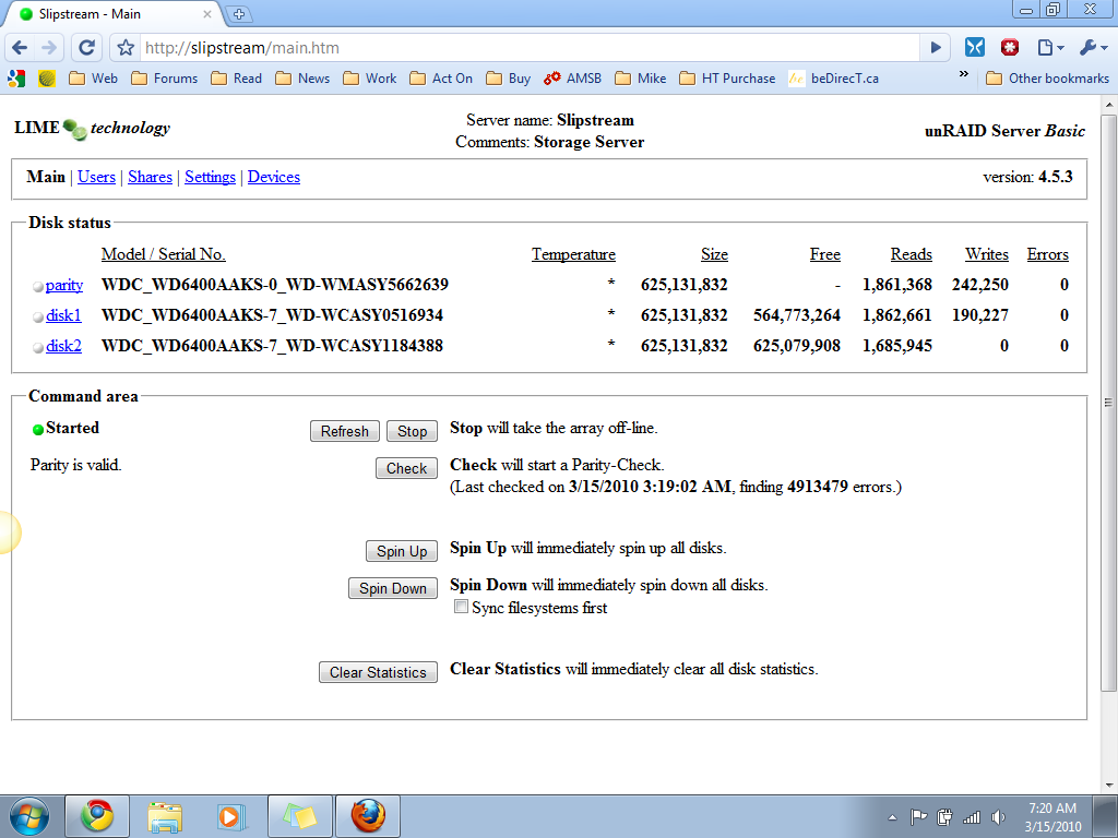

So I decided to just start using the box last night. I copied ~80GB of data to it and ran a parity check before bed. This morning, I was greeted with almost 5 million errors! Disk status was still all "green".
What would cause this? Unfortunately I did not capture the syslog as I only had time to shut it down before heading out.

General advice was all I could ask for this morning. I woke up to nearly 5 million errors and didn't even have time to get rid of weekend scruff so I just shut everything down and ran out the door.
So let's see what steps I can re-trace prior to this event.
- I had just moved my server from my work bench to the shelf underneath the staircase where it will live.
- I had tried swapping out my longer eSata cable to make my external enclosure (housing disk 1 at the time) work in the new space
- After realizing new cable was not appreciated by the promise controller, I swapped back out to the original that had worked and made the physical arrangement work.
- I transferred a bunch of data to it (sorting as I go, so mostly little chunks at a time) with the exception of a ~22GB move of data just before going to bed.
- Everything looked good, no errors reported so I started the parity check. We know the rest.
My first suspect was the whole promise controller > esata bracket > esata cable > enclosure arrangement so I dug around for another 4-pin esata power adapter and plugged disk 1 in direct as the rest are. I've read quite a bit around the forums that cables can be an issue and I figured that could fall into that category.
I then started Memtest (love that it's a built in option by the way) and just over an hour into it I see no errors. I know I should really let it run for a good amount of time (especially since I haven't done so yet with this setup) but I think I'd rather start another parity check tonight to see if brining the drive internal helped at all.
I'll try to wake up tomorrow morning in time to de-scruffify AND at least collect syslogs if they haven't improved. If they haven't, I might consider that road-trip South after all...
Edit: It appears my suspicions were correct as this morning's check led to 0 errors. I knew that the whole external setup was rather fidgety and this just confirmed it. Now I just need to get more creative with finding ways to get proper ventilation with 3 drives in that tiny case. (Hope tax season blesses me with new case money :)
