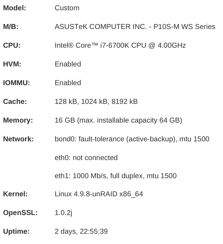

Just tried with 6.3.1 with SeaBIOS and i440fx
Same error.  >:(
Trying to setup a vanilla LibreELEC from the LT VM section...
Specs on attachment.

I did get it to boot. Seems it was whenever I choose the integrated sound card ("Intel Sunrise Point-H HD Audio") it wouldn't boot. Choosing no sound card lets it boot fine. Maybe the integrated sound card and video are in the separate groups?
Edited by drzaph
