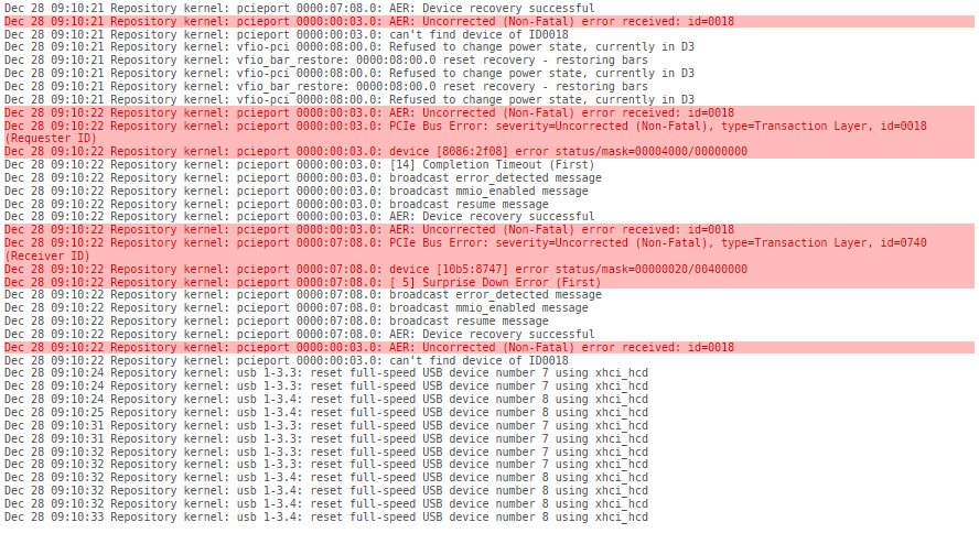

I thought I ask but when I pass-through my USB PCIe card the VM normally locks up when I go to restart and I have to force stop the VM then back on. I am seeing this error come up in the UNRAID log when I reboot the VM,I have attached the screenshot.
It's hard to draw conclusions from such a small excerpt, but it appears that 3 separate devices are not handling the restart very well - 0000.07.08.0, 0000.00.03.0, and 0000.08.00.0.  If you grab the Diagnostics, you can check the lspci report to identify those devices.

I am currently using UNRAID 6.3.0 rc6 and attached is a zip folder with syslogs and screenshots. I have also tried it with 6.2.4 and the same issues are there.
