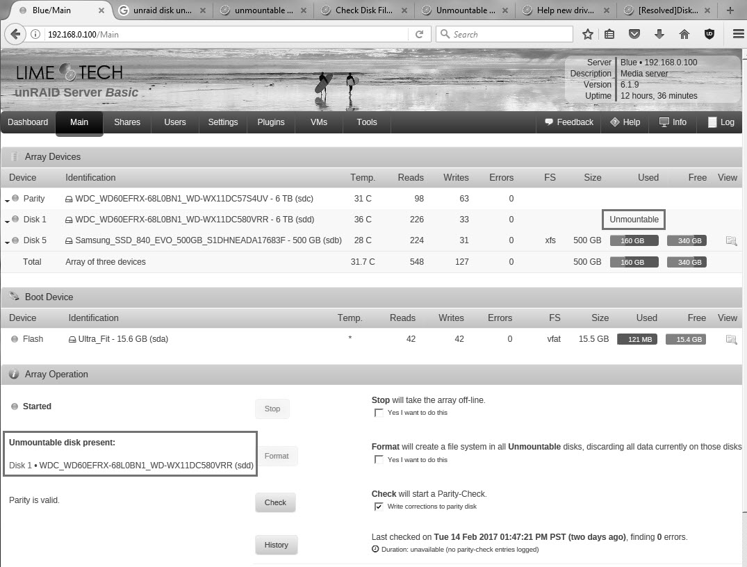

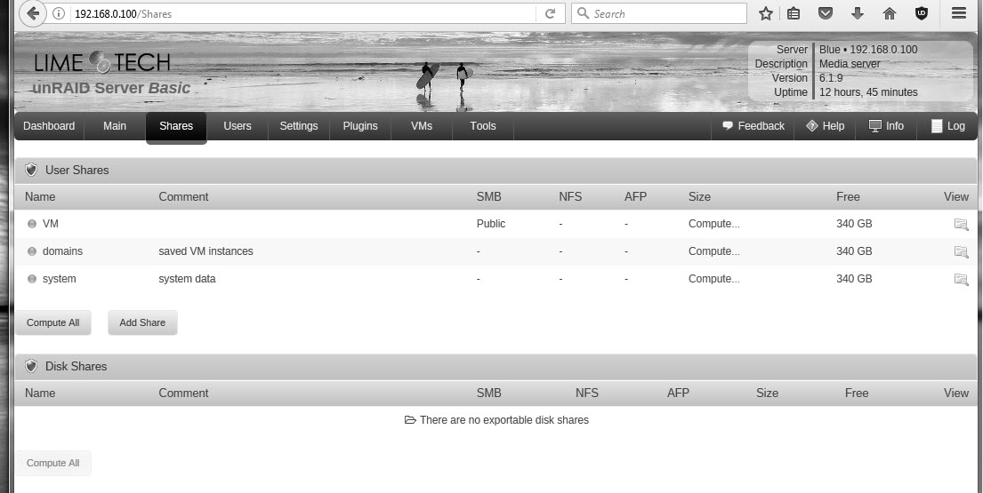

I am having issue for the last 3 days with one of my hard drive which reports "Unmountable disk present" (please see attached snapshost and dignostic file). I used to use for the last month the verion 6.2.4 but yesterday I reverted the unraid ios to the version 6.1.9 and this didn't make any difference. I have got currently two 6TB WD Red hard drives and one ssd 500GB. One of the 6TB WD Red hard drive is reporting the issue and the status is "Unmountable". I have tried to check the parity and run the smart full test which took about 11 hours on Disk1 which reports "unmountable" status but I couldn't find any errors. I also cannot see my shared any more.
I have attached all diagnostic files but I don't know how to resolve this.
Could someone please advise what would be the next step which I should go for ?

Completely unrelated to your problem but worth mentioning anyway, assigning an SSD to an array slot is not advised. While it isn't forbidden and the system does allow it, it isn't supported and can cause problems in the future. Furthermore, its speed advantage is largely wasted as you have a mechanical parity disk. A better use of an SSD is as a cache disk, where it can be used to store your docker image and any VMs. There's a discussion thread here.
HI,
Thank you for your prompt respond. Sorry but I've forgotten to mention that I use ssd only for running VM and it's not part of this array.
