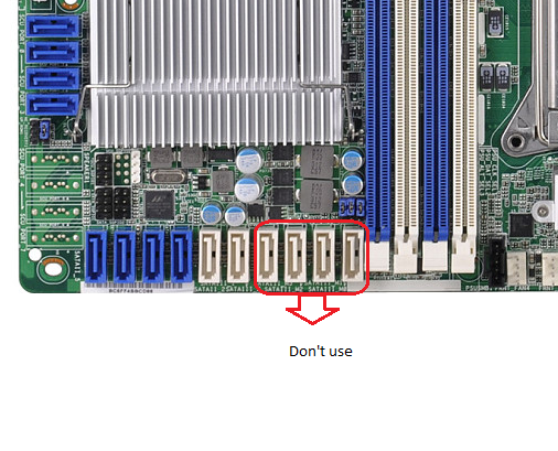

One more thing, the Marvell ports on those Asrock boards are notoriously problematic, you want to avoid them at all costs, you have enough Intel PCH ports for all disks, your SSD and one of your disks is on the Marvell controller, do you wanna guess which one is there?
To sync parity change both devices using the Marvell controller to the Intel ports, then unassign parity, start array, stop array, re-assign parity, start array to begin parity sync.

The 2 white sata conectors just at the left of the "marvell DO NOT USE conectors" I suppose are the 6Gb/s. Perhaps will be better to attach parity and ssd to this connectors and let the others for the data disks?
Yes, use one of those for the SSD, for HDDs sata 3Gb/s is more than enough.
