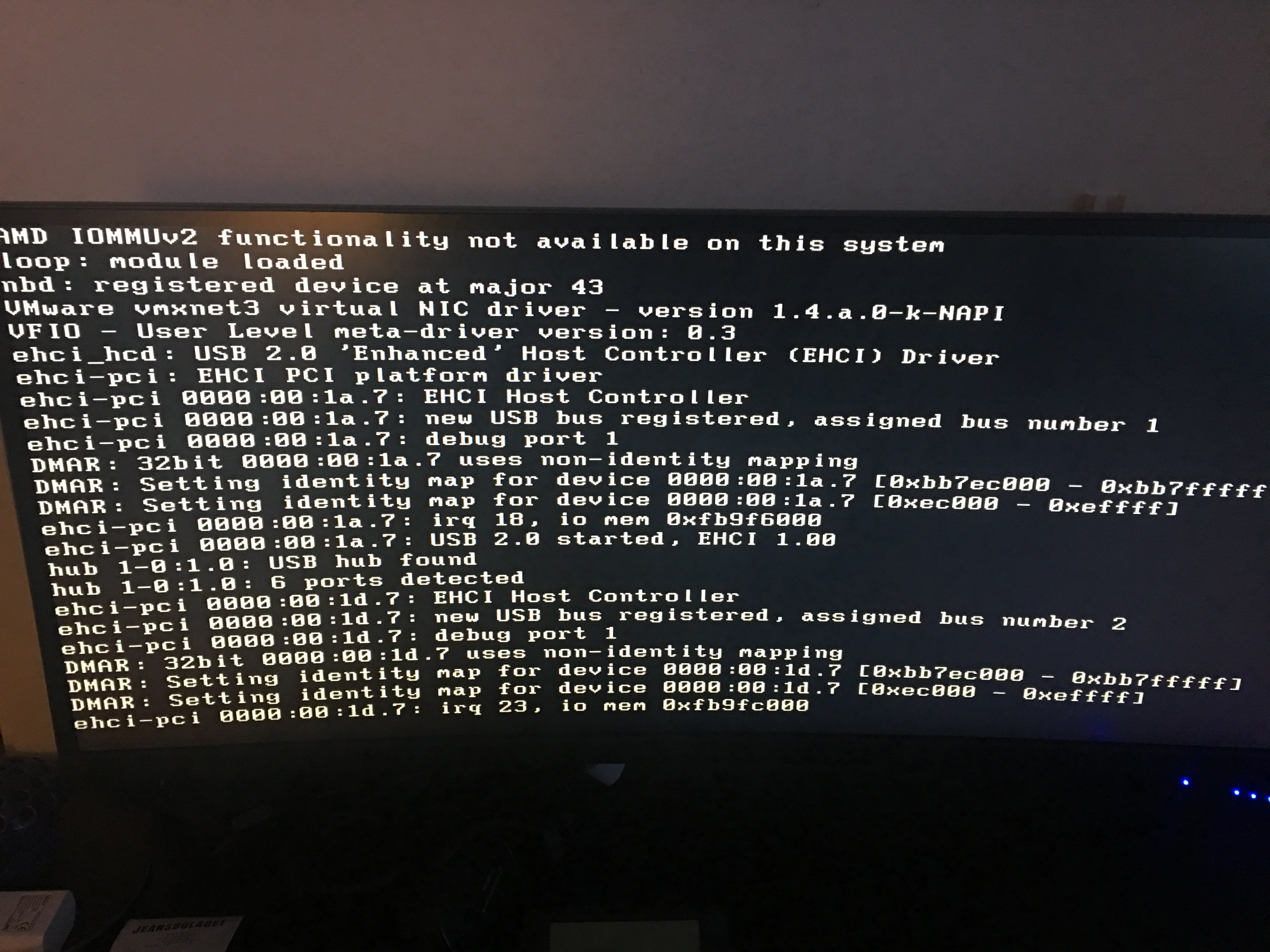

I decided it was time upgrading Unraid from 5 to 6. After cleaning up my boot drive and making it bootable the bootloader is installed but when the os is initilizing it stops at "Ehci-pci 0000:00:1d:7 : irq 23, io mem 0xfb9fc000"and after leaving it for 6 hours and then 12 hours but still no results. Tried googling and reading the unraid wiki but havent found anything usable.

edit: attached image of screen

It would be worth trying the boot drive in a different USB socket, if you haven't done that already.
What is preffered, USB 3 or 2? Should legacy boot be enabled in BIOS?
USB 2 is generally more reliable for booting from but since the problem controller is a USB 2 one then yes, do try USB 3. Yes, enable legacy boot.

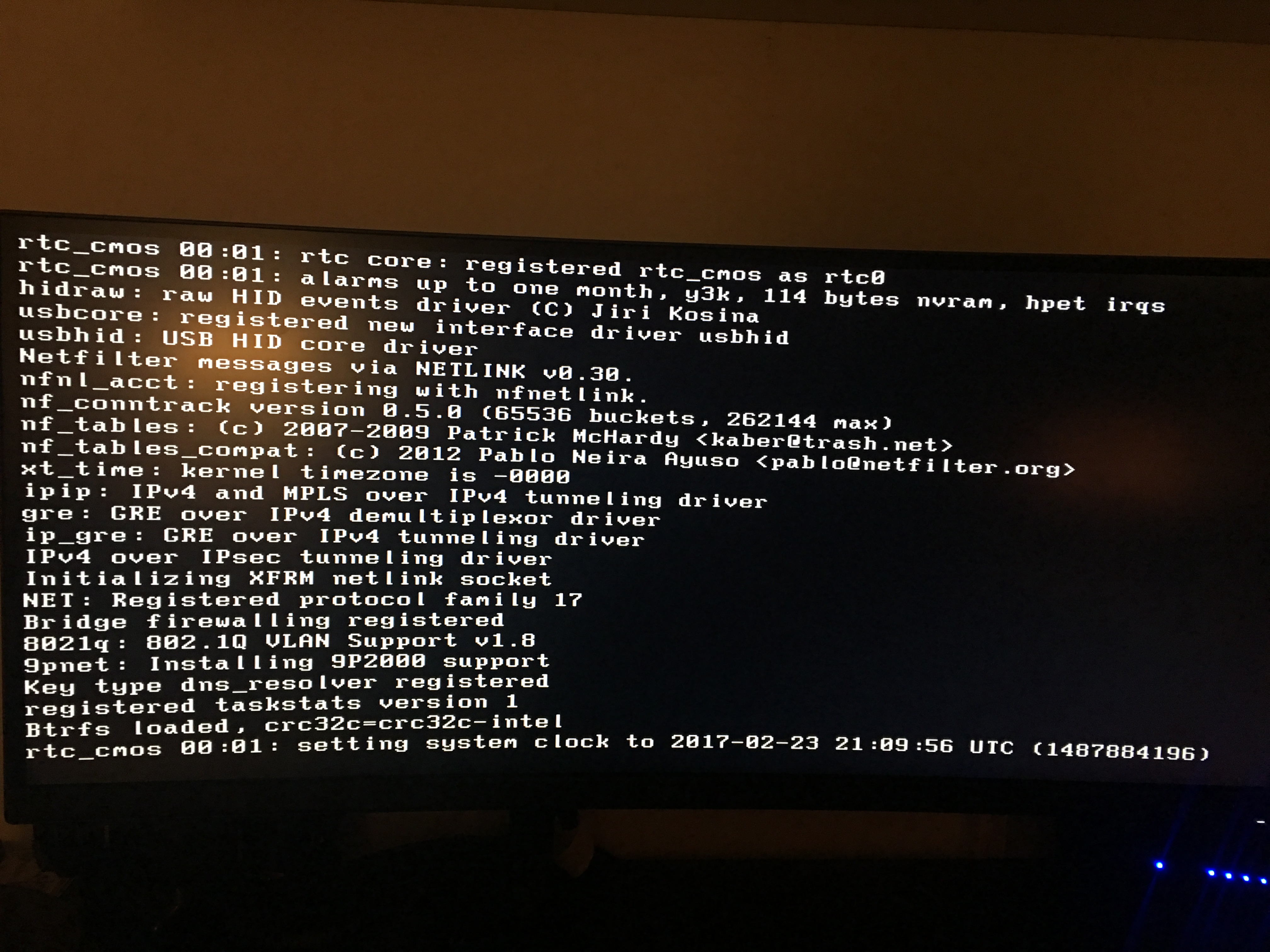

I'm losing my mind, still haven't gotten my computer to boot Unraid. Downgraded the usb stick to 6.2.4 and got stuck on
"rtc-cmos 00:01 : setting system clock to 2017-02-23 21:09:56 UTC (1487884196)"
