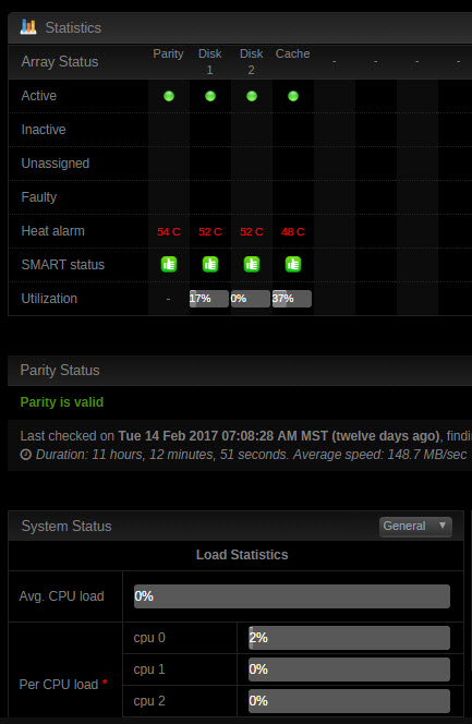

I'm new to Unraid.  To run Unraid, I purchased a Dell T20 Server with Xeon E3-1225 v3 3.2GHz, 16GB RAM.  I've installed a 240GB SSD as Cache, HGST 6TB NAS Drive as Parity, and (2) HGST 5TB NAS Drives in Pool.  I've got the Unraid Server running in my air conditioned home at a temp of about 75 Fahrenheit (24 C). The Temperature of my disks seems to be running in the mid to low 50s while being utilized.  I'm not sure if this is something I should be worried about and if it is, how can I start to troubleshoot the cause?  I'm purchased (2) WD Black 5TB drives but don't want to add them until I get the temp under control.  Thanks in advance.
Yep, I stopped using mine for this reason.  A low speed 92mm fan and terrible drive placement means drives run super-hot.
