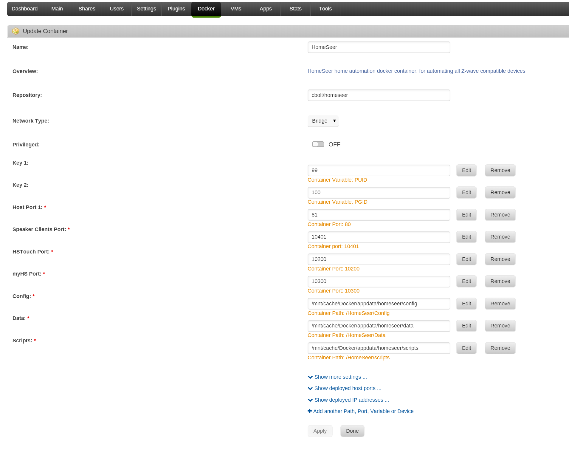

I know this post is dated, but since I came across it while attempting to do the same setup, I figured I'd follow up to let you know that I was able to use the Homeseer container found here to easily setup a container in Unraid and it's been working great. I've attached a screenshot of my container settings for reference in case it's needed. I modified port 80 to 81 since I use 80 for the Unraid webUI.

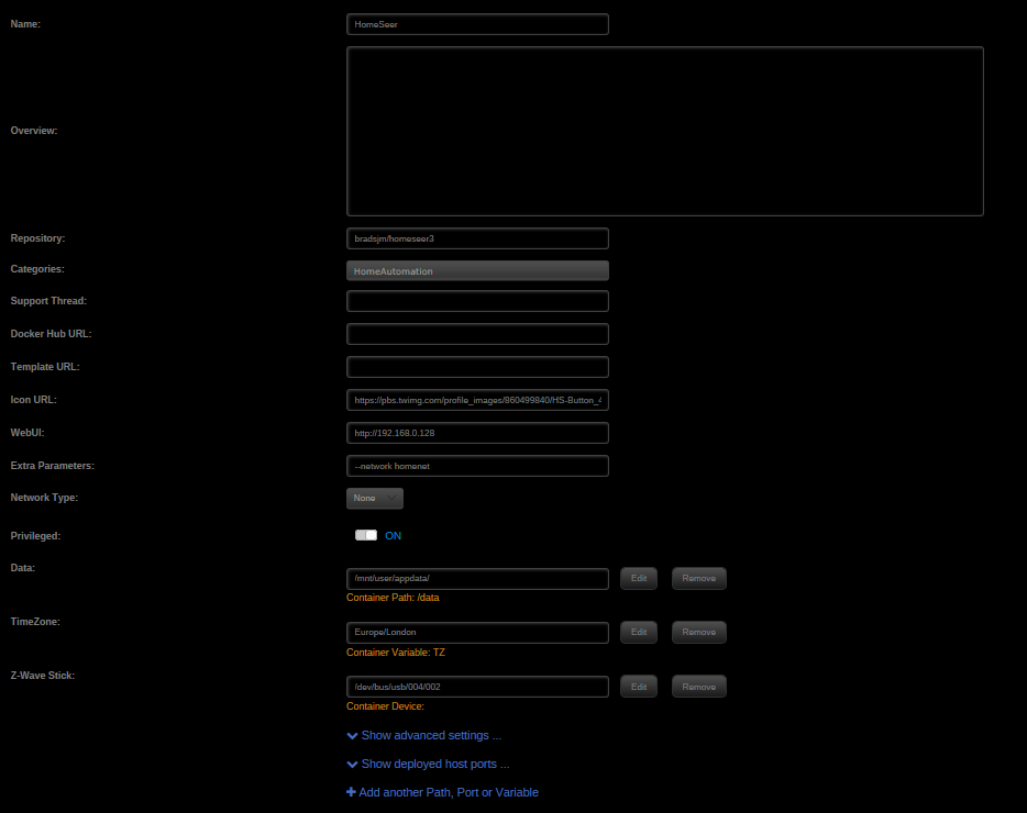

I was using the setup for some time, but was having trouble with some of the apps on other devices attempting to connect to HomeSeer.  The IP being returned from MyHS was an Internal Docker IP address.
I did some digging and now my HomeSeer Docker container picks up its own IP address on my network :-)
I don't have to configure the ports here and all the Apps now function correctly.
I should have bookmarked where i found the information on how to set this up with Docker.  Some Command Line entries are required along with the extra Parameters specified below.
Just Thought I'd share :-)

@techno_81 Thanks for responding.
Once i d/l the file from Homeseer and unpoack it on to my cache, i can use your settings and repository from your screenshot and it should work?
Adding the docker should download everything for you.  You will need to enter a licence key in the Homeseer web settings once running.  Note the IP address, you may need to enter a different one based on your network setup.
Thanks.
I will move the files i d/l'd and re add the docker using the above settings.
As for IP, can i use bridge or do i need to specify?
That's up to you and how you want your systems to work.
My preference was to let HomeSeer have its own dedicated IP address so i didn't have to configure multiple ports when adding new plugins etc.

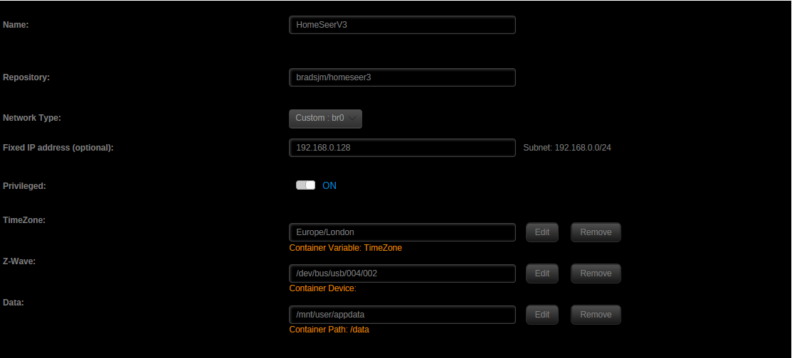

Using the settings similar to mine, i just enter the address http://192.168.0.128 in my browser and it opens.
you can open the advanced docker settings and enter this as the WebGUI URL also so you can access from the Docker screen.

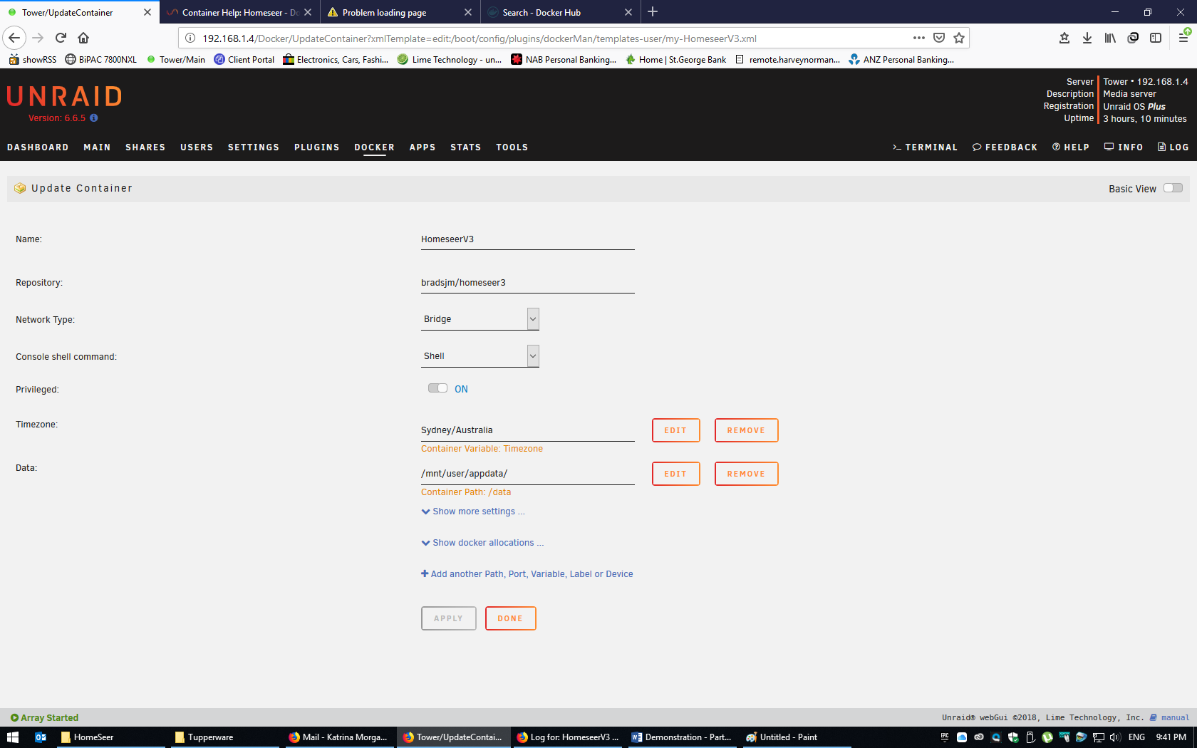

i used the same setting but changed network type to bridge.
In the logs i can see an IP address and this matches http://find.homeseer.com. which is 172.17.0.2, but clicking on it just times out. This was happening previously
can you post a screen shot of your homeseer docker settings?
As in this one?
That's sounds like one of the reasons i set up the dedicated IP address.  Need to configure this in the Docker settings also.
If you have used the bridge settings, then you will also need to add the ports for the docker container.  The homeseer will be accessible via your UnRaid IP and the ports you configure in the docker container.  8080 to 80 for e.g.
2 minutes ago, bdydrp said:
As in this one?
Yeah, if you are using the bridge, you will need to add the required Ports to the configuration settings. so they can pass through to the Homeseer docker.
Thankyou so much!
Changing to fixed IP has done the trick, for shit and giggles i used the same IP.
Now i know it works, i can work backwards and change the IP to something i want.
Again, appreciate all your help
