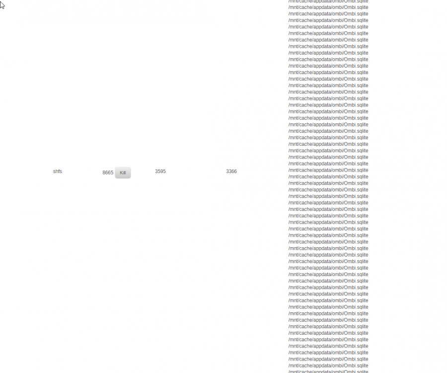

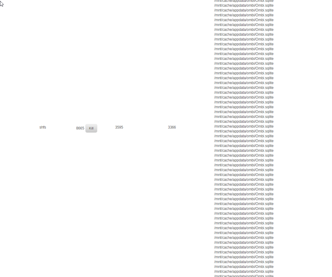

Interesting, where can I find the "Open Files" plugin? This is all new to me. Cant see it in the Plugin tab on Webui.
Edit: Might also be related to Ombi too, the problem starts at the same time for the last few days. Around 8 in the morning. Keep seeing Ombi cant open files cause of the "Too many files open" error.
Second edit: Just installed Open Files plugin, why the hell does Ombi need so many file open??
Uploading a pic of the example im being presented, this goes for pages.
Third edit: Killed the Ombi Docker, seems too be normal from the Open Files Plugin, gonna let it run for a couple off days to see if the problem still exst. Thanks for the help trurl. Gonna be interesting to see now.
Edited by kentromox
Third edit, Holy god why...

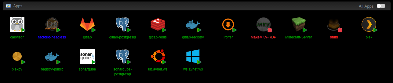

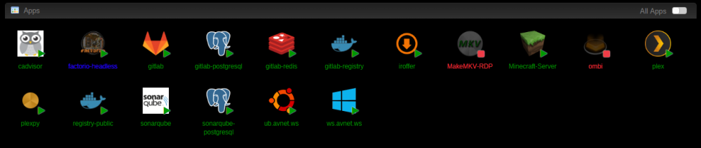

This is a very interesting read as I just migrated (about 3 or so hours ago) my Ombi container from a Synology to unRAID; which is running, well, this will do the talking for me:
Lo and behold, will you look at that -- I get my first OOM with unRAID ever.
First noticed this while browsing GitLab -- my images weren't loading.
Then it was WinSCP -- my NFS shares were going bye bye (this part is scary lol).
I wasn't able to capture the moment when it triggers, but Ombi is the only new element in my system.
I'm speculating (since this is what it was doing after installation) that the episode searching is what's causing the OOM issue (related: https://github.com/tidusjar/Ombi/issues/1256)
It doesn't help that I already have a high amount of open files (looking at you SonarQube) so it didn't take much to tip it over the edge.
This system stays fairly busy so I won't be able to provide any more info than this -- just wanted to confirm that Ombi is the common element.
I'm hoping those guys can move away from Mono and onto .net Core -- I can see a good app, just not under Linux.
