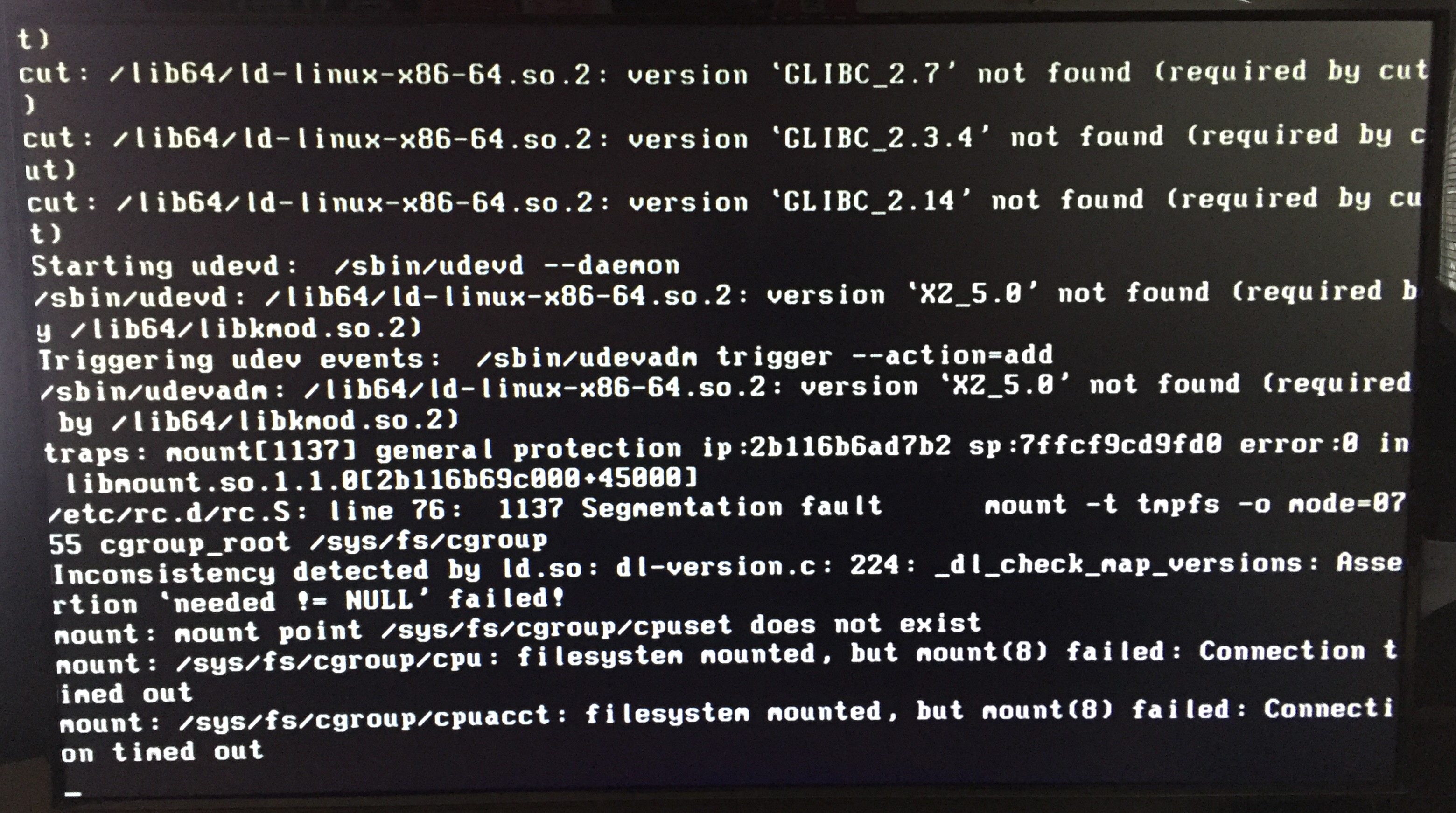

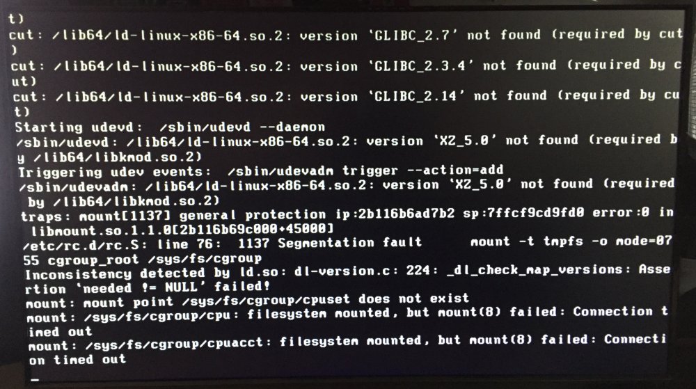

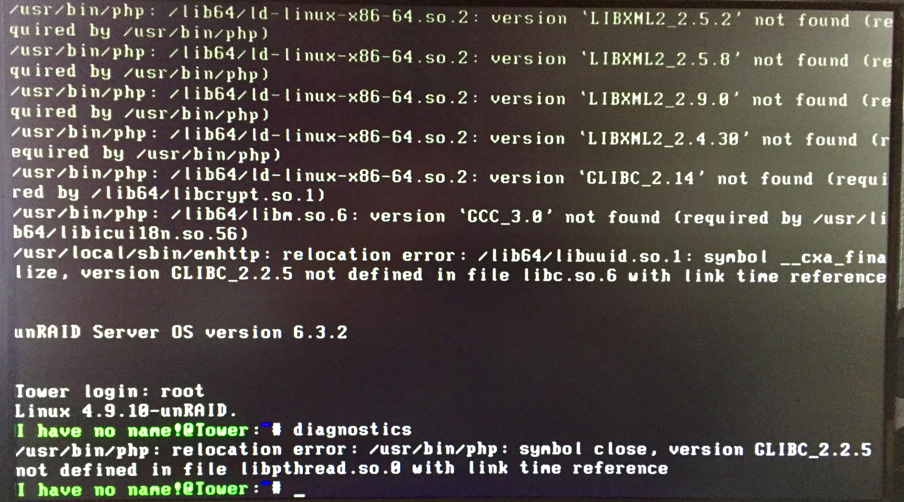

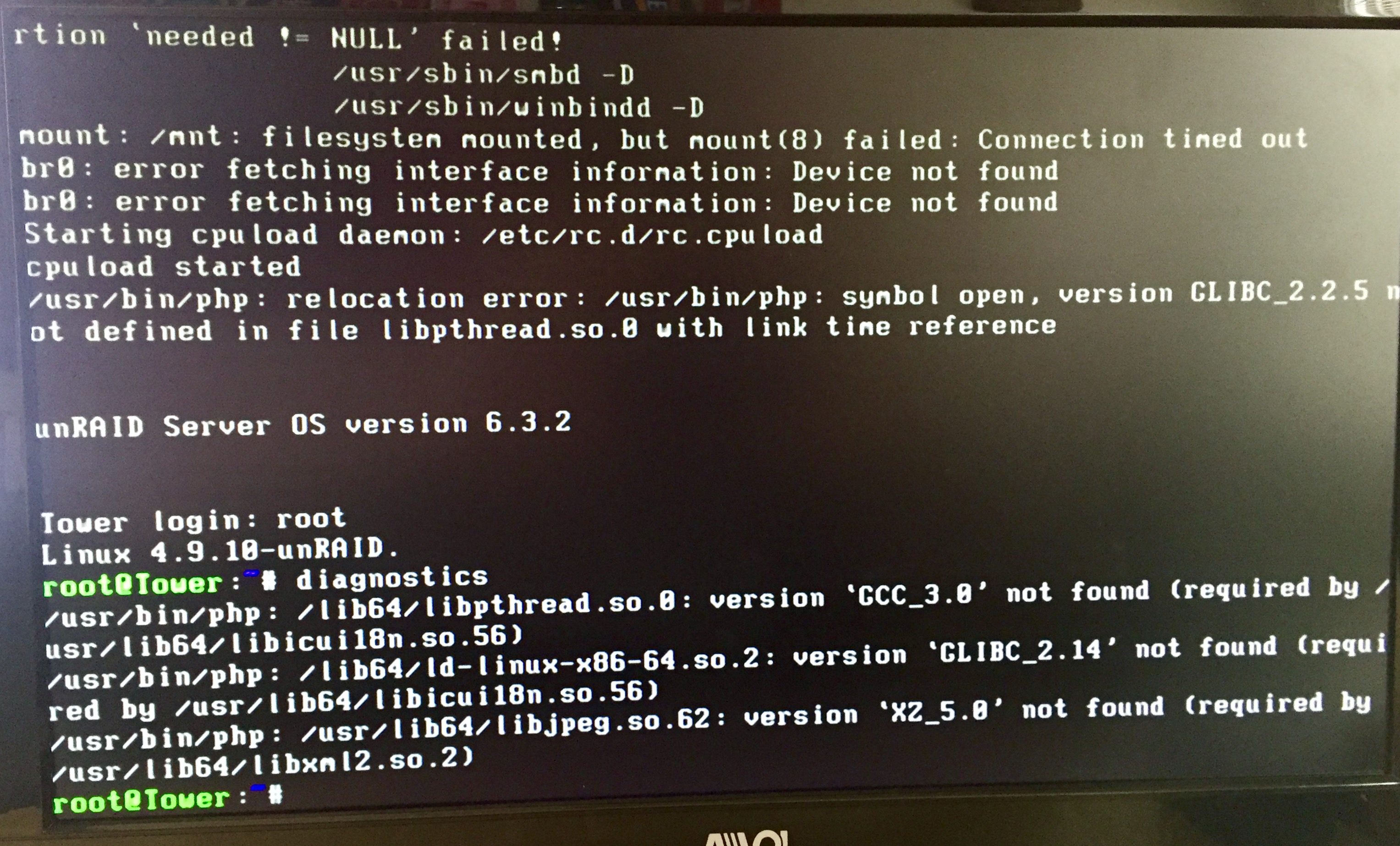

I am failry computer literate, but a relative noob at programming.  I have a stable system for 6.1.9 (ive had the system for years, good recent parity check and good 'fix common problems').  I tried upgrading via the web gui to 6.3.2 and it failed (unstable system, doesn't appear to actually finish the install or start the array, no gui, etc). I've scoured the forums for advice.  Same happens (failure, unstable system) when I just replace the bzimage, bzroot, and bzroot-gui from 6.2.4 or 6.3.1 or 6.3.2 onto my stable flash drive that was running 6.1.9.  I tried starting in safe mode after updating, same problem.  I tried just booting a clean 6.3.2 with my config files (minus go and syslinux) and same problem.  I have attached my diagnostics report from 6.1.9. I have attached screen shots of terminal of the the end of the 6.3.2 install. I can't run a diagnostics or capture my syslog from terminal after upgrading (nothing happens).  I appreciate any help getting my system upgraded.  thank you.

nope.  same problem as before (see pics from original post).  server reports it updated to 6.3.3, but if I try logging in and running "diagnostics", it doesn't seem to work.  (this is all from the local monitor, as there is no LAN connection).
