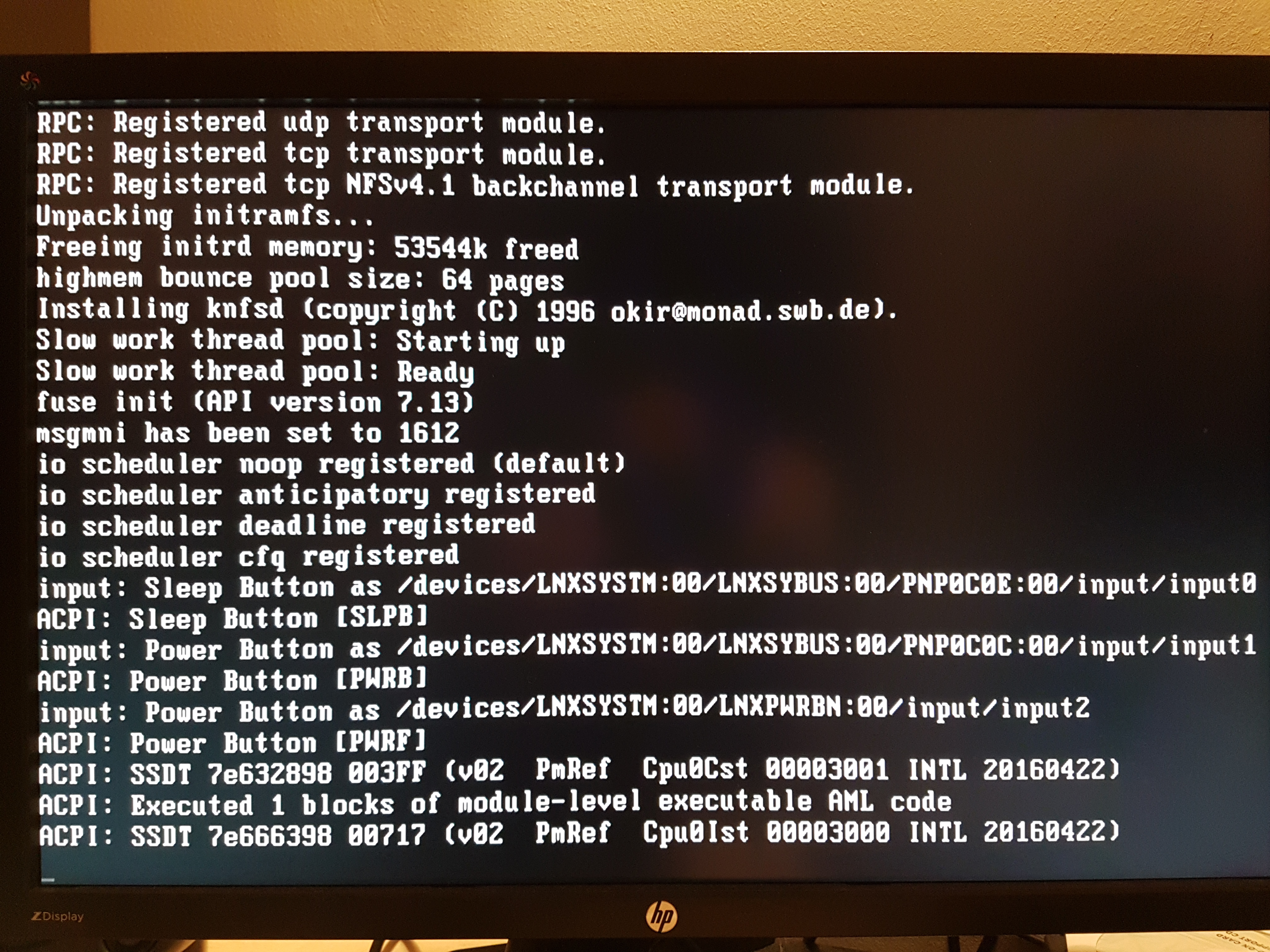

Ok actually changed strategy. I put all HHD of old Unraid into the box of my new Unraid, inserted the corresponding USB and boot. Problem is its stack at string:
ACPI: SSDT 7e666398 0017 (v02 PmRef Cpu0Ist 00003000 INTL 20160422)
Is that a dead end?

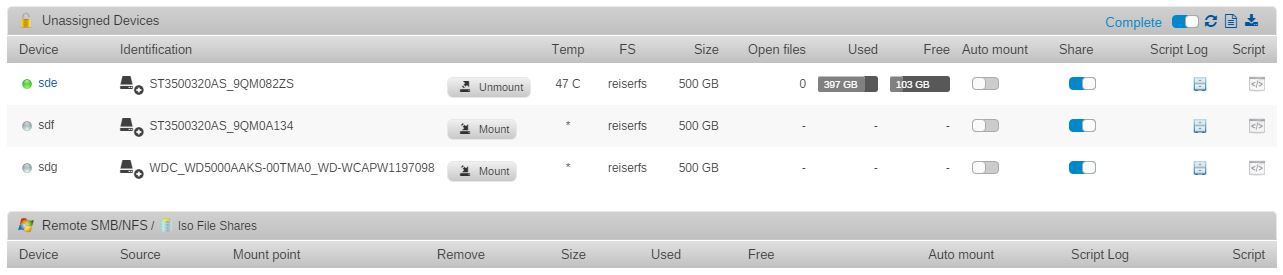

Thank you so much for your support! I am trying what you said. The only thing that troubles me is that I have only 6 ports and the drives of the old server are 6 and the new 3. So I will do it in parts. First 3 disks and then 3 more.
Ok I mounted the first 3 disks. Tried to access one disk from the explorer of my desktop returned "You do not have permission to acces \\bla bla bla disk Contact you network admin bla bla bla....

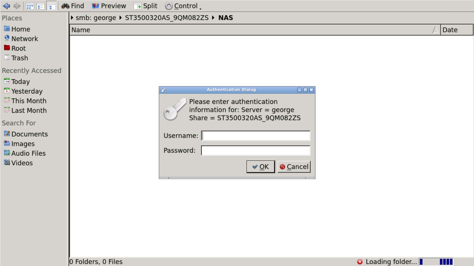

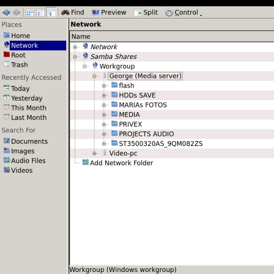

Thanks again. Ok, I have never used console, have no clue about it, but I guess I can try to learn... With dolphin I had some luck but when I managed to mount my drives and tried to access the contents from the web ui it again asked for user and pass but I have no clue about it.
Thanks for your patience....

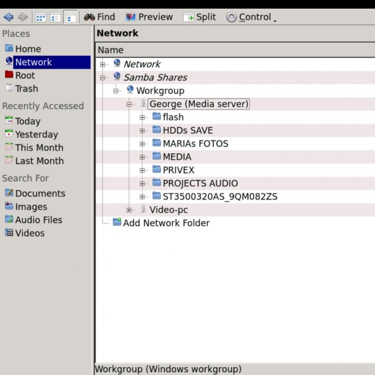

This is what I get in Dolphin
Do the HDDs need authentication because of the unraid system they were before? I dont remember specifically creating any kind sequrity.
Any help?
Use the /mnt/disks/whatever path listed for the disks in unassigned devices, not the smb share.
You are using the dolphin docker in your new unraid, right?

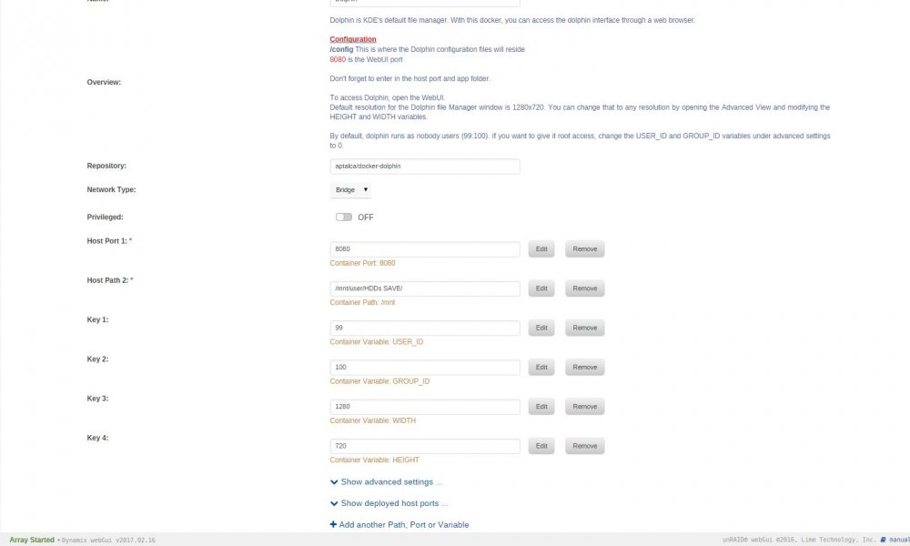

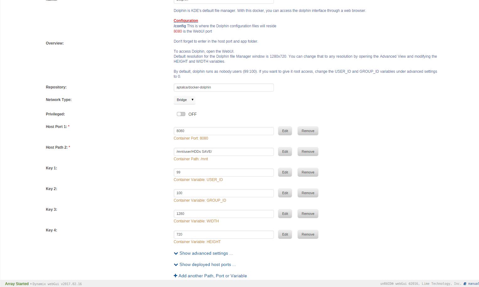

When you say "use the /mnt/disks/whatever path you mean in the dolphin settings? Or in the Unraid main page? Look at the pics
Thanks
Change host path from /mnt/user/HDDs SAVE/ to /mnt
Then in the dolphin window your unassigned devices disk will show up if you click on the red Root folder and navigate to the /mnt/disks and you can copy the data to your user shares in /mnt/user
Don't use the network location in dolphin for this, you are local on the server.
Also, if you haven't used dolphin before, it will make it easier to copy folders if you click the split button on the top row to give you two windows, that way you can open the /mnt/disks location on one side and the /mnt/user location on the other.

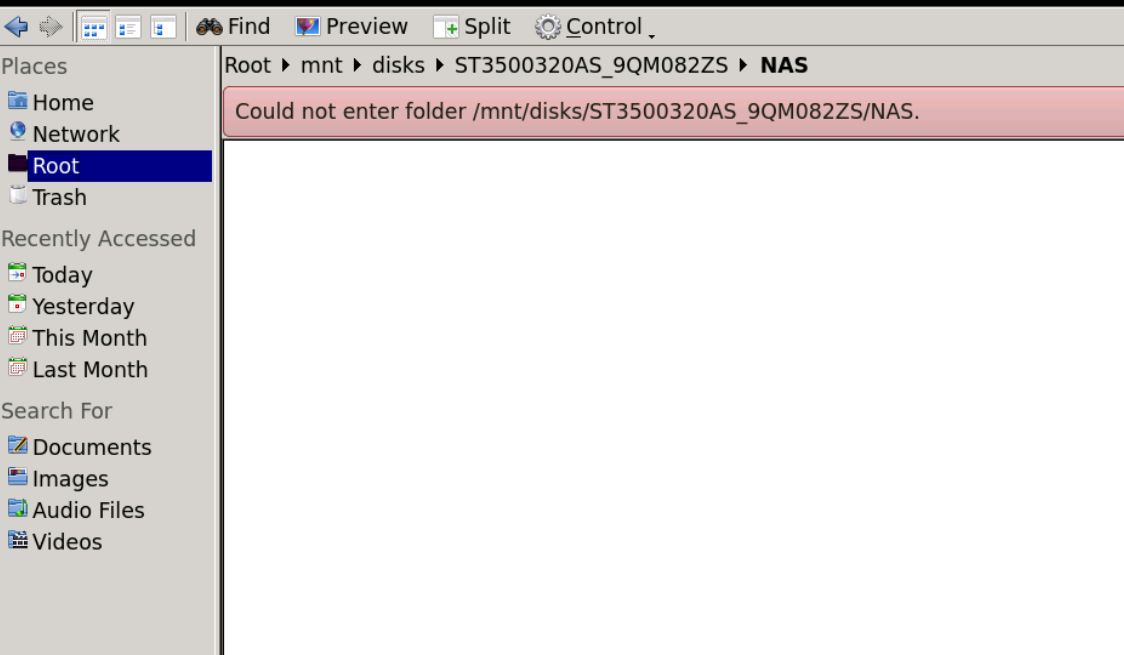

Still I cannot get inside the disk to see folders and files.
Thank you very much for your support, I hope it will be solved...
Did it, exact same thing.... "could not enter folder......"
