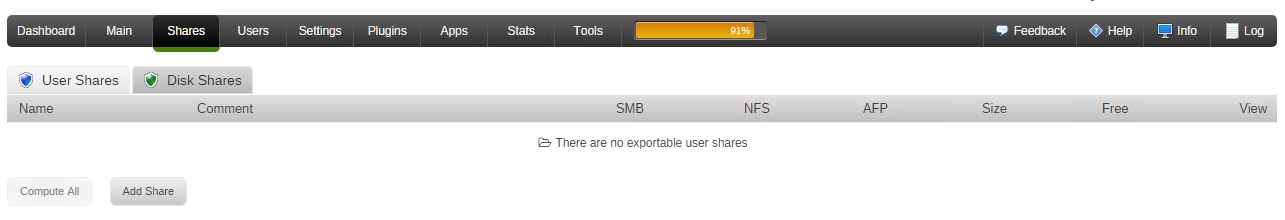

Description: Randomly, my user shares will completely disappear from unraid. Leaving all of my machines (connecting via NFS) unable to access any of the data. The shares do return if I stop the array and reboot unraid.
How to reproduce: No idea how this is happening. I do have a log file attached from right when the incident occurred. (unraid_log_04072017.txt) It shows some warning/nfsd error.

@itimpi @trurl hey guys, it happened again. It has happened a couple times today, but I was able to snag a diagnostics the most recent time. See attached.
The whole server goes somewhat unresponsive for a bit of time, it did eventually come back tho. Shares went missing and all my servers were hanging trying to connect via NFS. I think it happened right at about 22:27 timeframe
