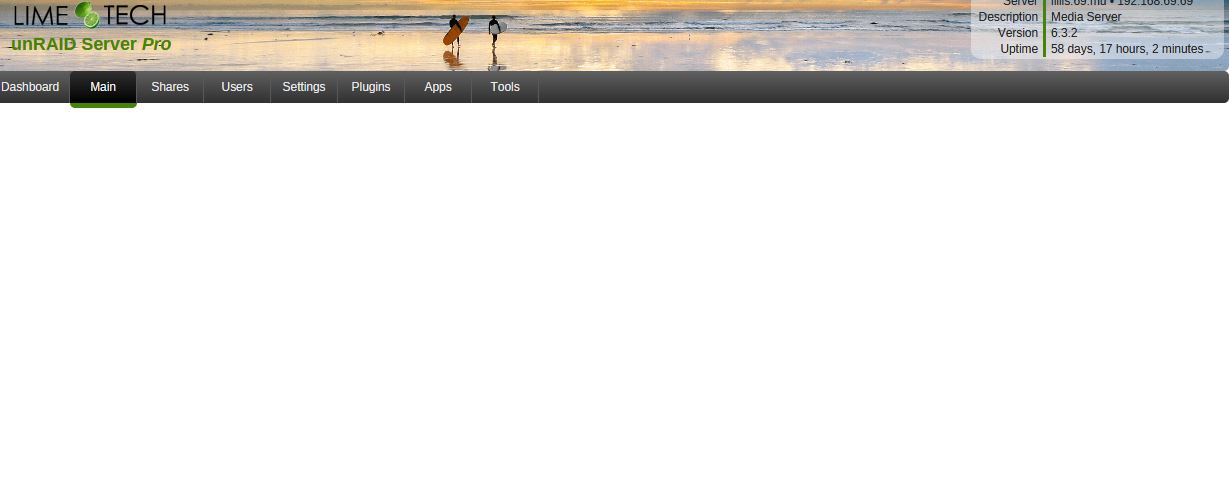

I can only use the header for the webui and it keeps prompting for preclear statistics install.  I dont know my drive assignments and it looks like maybe the flash drive has gone south.  Attached is syslog
Maybe a screenshot would clear that up.
I dismiss the statistics demand prompt and I get just the headers. Attached is historic log
syslog1.zip
screenshot
