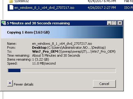

Hello i notice that when i copy files lets say 3GB ISO file, I am getting a network trans of 20kb.

Less be clear I only added a 2nd nic to the source server to see if it would help. still getting 20kb/s (showing on the unraid  server)
when adding a 2nd nic did not work I tested a transfer from other source server on the same switch same 20kb/s
What should i be expecting for for a transfer rate 1000MB port switch, 24port switch but only 2 computers on it.

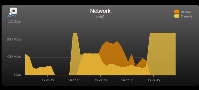

This is speed I get transfer from one WD Black to another to give a ruff idea on single drive 7200 RPM performance. z170 Chipset.
whats that look like in system stats under network ? how many kb/s

Are you sure that you Ethernet is coming up as 1GB.   The speed you showed in the screenshot look suspiciously like what one would expect from a 100Mb Ethernet.   It is always worth checking the Ethernet cable is not the issue.   1GB Ethernet requires 8 wires connected in the cable while 100Mb only requires 4.   Therefore a bad connection in the cable can cause speed to degrade to 100Mb.
Cable is a good idea to check - and try an other port on the Switch too - this rates are very low. If it would be 100MBit, you will see around 9,5MB/sek max and as mentioned bevore, 1000MBit will give you 92-115MB/sek.

When you do a file copy in windows its showing 11.1Mb/Sec But i dont really trust Windows Copy speed numbers.
what do some of you see ? in windows and from unraid at at the same time.
Edited by zdude
Wenn i copy between my Windows machines, i see up to 118MB/sek (944MBit) - 1000MBit-LAN in my home.
Wenn i copy data from or to my unraid server, i see max. 95MB/sek (760MBit) , but i use an old Intel Pro 1000 PCI NIC - so thats normal.
Your 11,1MB/sek means max. 88.8MBit.

I may have fixed the issue. I rebooted the PC to check i had the most current BIOS (I DID) and  now i am getting 961.8MB/S.
thanks for the help..
much better, dont know what happen but its better.
