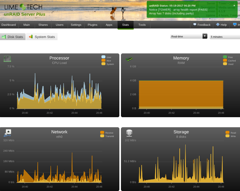

Been doing this for about 7 years. About 2 weeks ago I replaced one of my 1TB drive with a 2TB drive and changed the format to XFS from Reiserfs..  Recording was good and playback was flawless but since the change whether it be Drive (which way faster than the older 1TB drive) watching a show is painful with pauses every few seconds. Now is this an XFS issue or a Ram or Network issue. As I said playback and recording was great before the change. Why would XFS cause issues when Reiserfs did not? It also affects the recordings as well. The pauses coincide with the spikes in the storage image. The green area is where my wife stopped playback of her show "Dancing with the Stars" and deleted it.

The display of network traffic is not quite what I would expect to see.  Those sudden peaks and then the data rate seems to drop to virtually zero.  Of course, the scale was clipped on the left  size so it difficult to tell what the actual variation is...   What I am about to suggest may seem like witchcraft but let's start to eliminate possible reasons for your problem.  Reboot all of the networks switches and the router.  They all contain some sort of a computer with a fair amount of RAM usually running Linux and sometimes random things just 'happen' and they become hamstung.  In any case it only takes a few minutes to try...

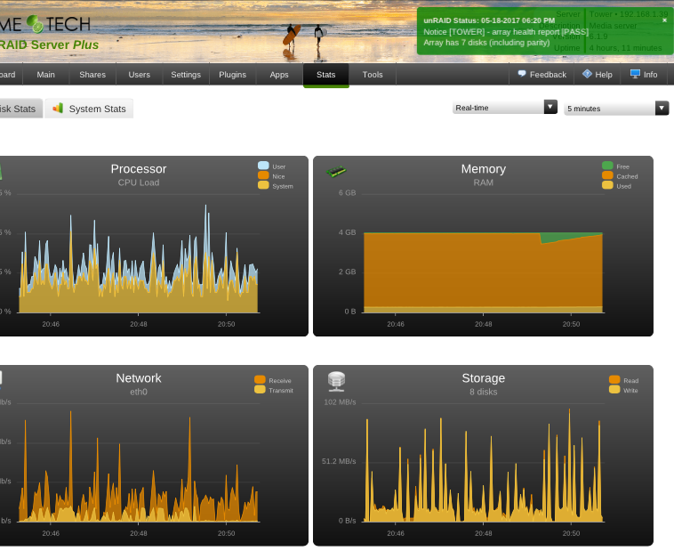

Sorry about the image being cut off, I'll post a new one.

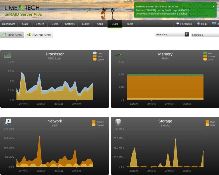

Update:
1. I upgraded to v6.2.4 since it looked to be stable, never like to live on the edge.
2. I added a cache drive, an older slower drive but by my calc more than fast enough to record 4 x 1080 streams at a time in real time at 71Mb/s.
The playback of the recorded shows with this setup played back flawless, previously recorded shows played back fine as well unless the recordings were affected buy the issue I was having. But there was no stuttering and pausing of playback in any case.
One issue I have with the Cache is, and I believe this is why I originally removed it is, that if I pre-program shows for the following day(s) or weeks the mover will move them as well as the already recorded shows of that day to the array then they will go back to recording to the array.  Also the first morning I checked the cache drive there was still 12gb of shows that never moved. I believe that was due to the app used for recording, EyeTV, was still up and running and the shows 'appeared' to be still in use when the mover moved. So the next night I had the MacMini & EyeTV shut down before the mover moved and all the shows on the Cache were moved to the array.
However I think the the big part of the problem may have been a memory leak in v6.1.9 because if you look at the v6.1.9 screen shot the ram is maxed out and when playback is started and ram usage is a lower level  but it eventually creeps up until maxed out and stays there. But with v6.2.4 the memory never maxes out, see the green area. This was after 4 hours of use. The effect I was seeing in the recording looked like an issue that involved collisions of the data whether network or ram.
