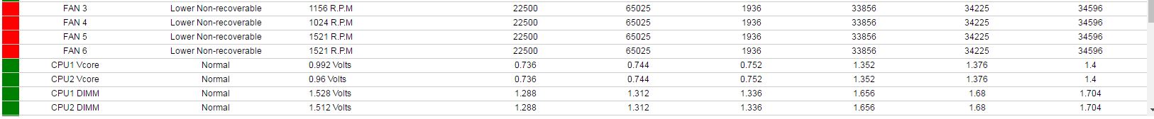

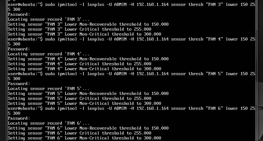

 Soo I had some Noctua 120mm 3-pin fans on the case and it ran them at 100% at all times. So I went and got some pwm noctua 4-pin fans and it works. However they spin lower than the thresholds of the allowed in the mobo. Now I have used ipmitool in ubuntu to adjust this same issue on my other supermicro board with the same 4-pin fans and no issues at all.
For some reason this time instead of changing it to what I say. It changes all the power level is over 9000..(65025).  any ideas?
The motherboard is X8DTL-iF
the same issue for me too some time ago, and fix is very simple - when you set value 150, it multiples it by 150 and you get 22500 ;)
if you wanna 150, use 12. 12x12=144
enjoy!
Edited by uldise

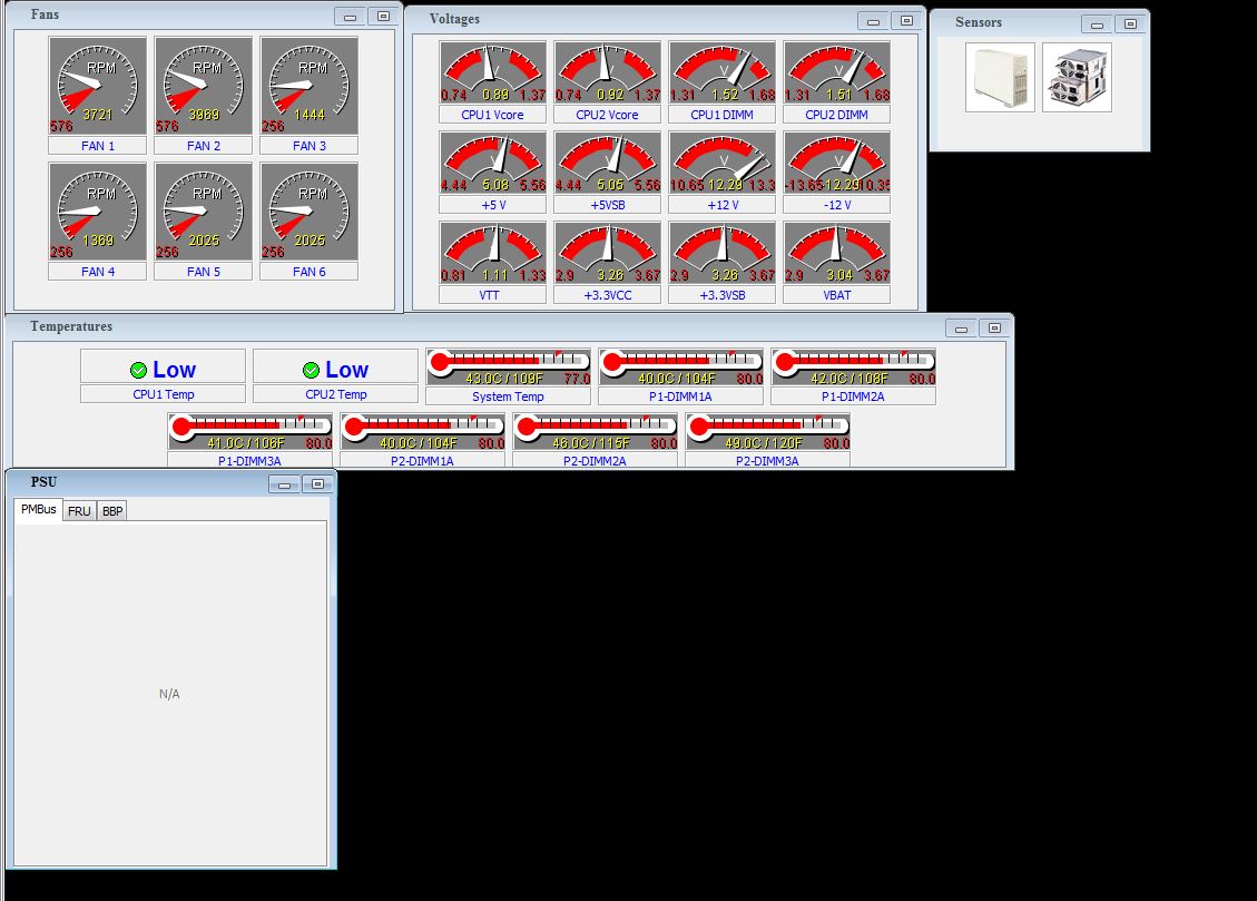

well that fixed that but im still getting a pulsing from the fans and its not even that hot...

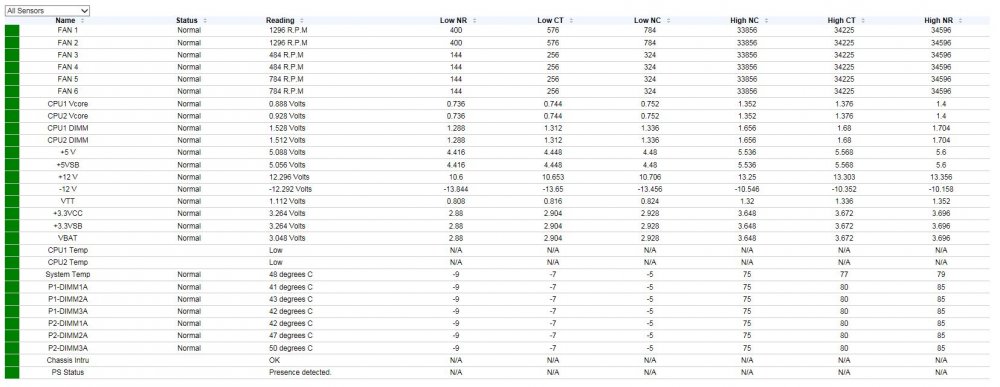

Logs is empty and everything on the web portion is showing green
i have the same generation SM board, two CPU's, six fans too. system temp for me is about 37 C on idle system, with ambient room temp about 22. (server is located in a small chamber with very limited airflow, no another options at the moment...)
are your temps from idle server or on heavy load? your DIMMs temp differs each other a lot, mine are nearly equal within the same CPU(differ max 1-2 degrees).

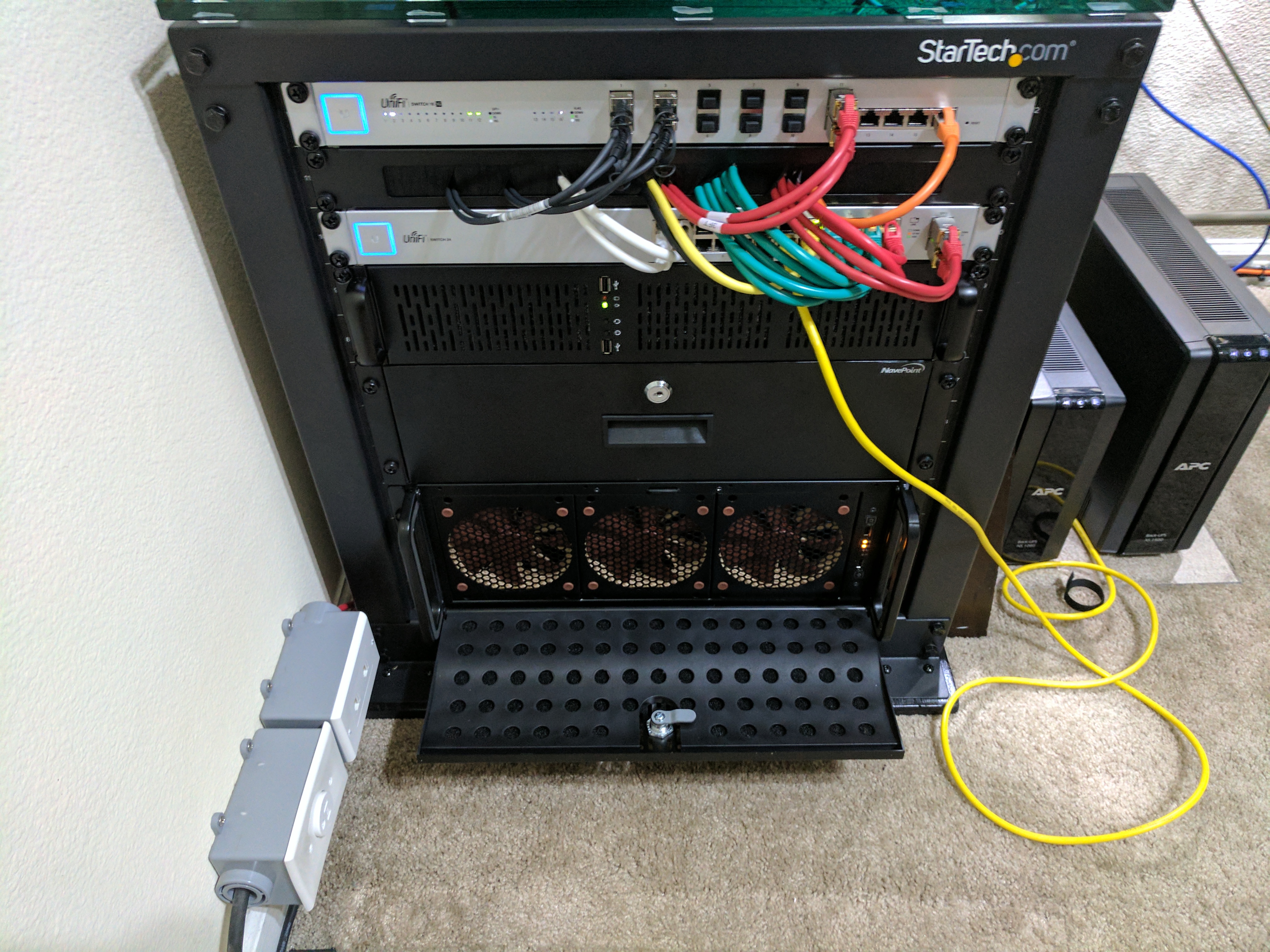

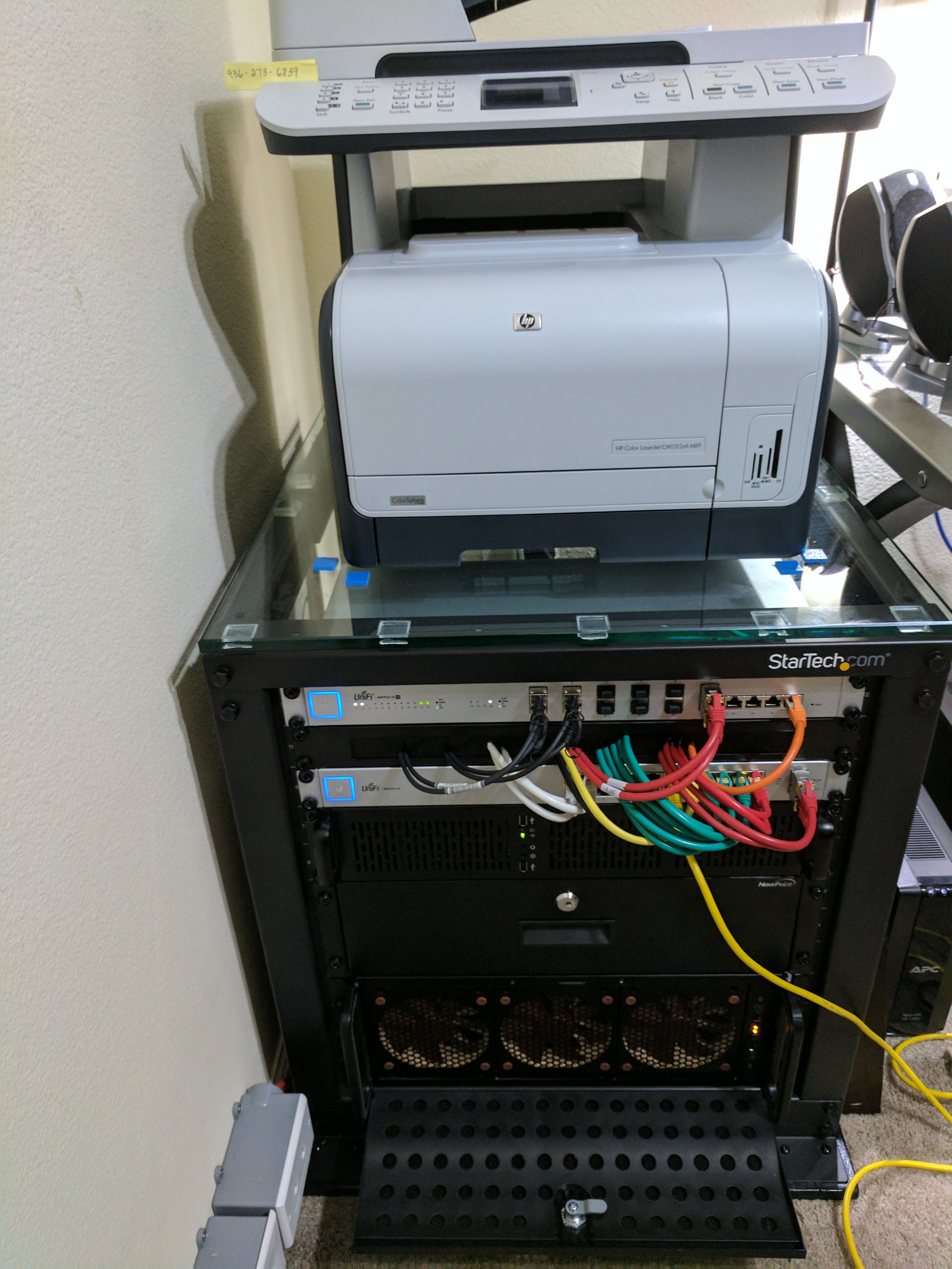

In the picture the server is turned off.
Edited by demonmaestro
nice pictures! :)
looks like your server are in the corner, what are the ambient temp in the room?
btw, what switches are you using?
Well when i was testing the server and setting it all up. With the lid off the server it hovered about 25c.
The ambient temp in the room stays generally around 24c-25c. With an overhead ceiling fan.

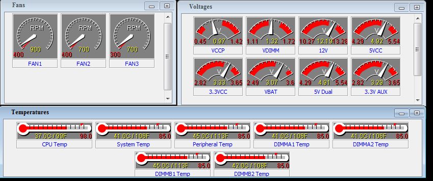

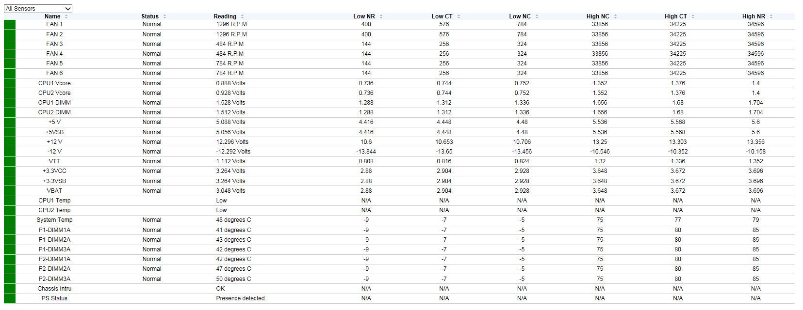

Here is the temps for the smaller 2u server. I have 3-80mm Noctua NF-A8 PWM and then I have a 60mm Noctua 60x25mm PWM sitting on top of the cpu.
The motherboard is a SuperMicro MBD-A1SRi-2758F-O
I don't have any surging from the 2u server.

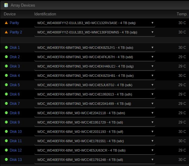

When looking at the hdd temps they are nice and cool....
yes, mine hdd's temps are about the same..

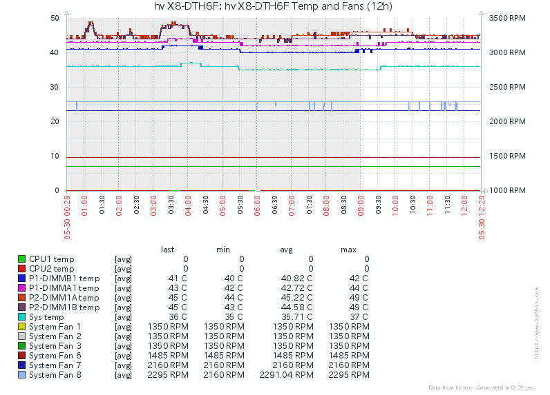

attached a pic for my server temps for last 12h.. you can see, one CPU vent is fluctuating a bit..
it did it much more when fan was mounted in direction not to front to rear but from right to left..

your rack is in the corner, right? are there enough space in the back to allow hot air to flow out from your server?
There is about a foot of space behind the server

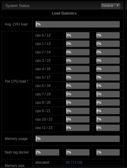

Here is something interesting I just found out. I had started the array in unraid and all fans went to 100% and all its doing in a parity check. cpu load is at 2%-3%...
