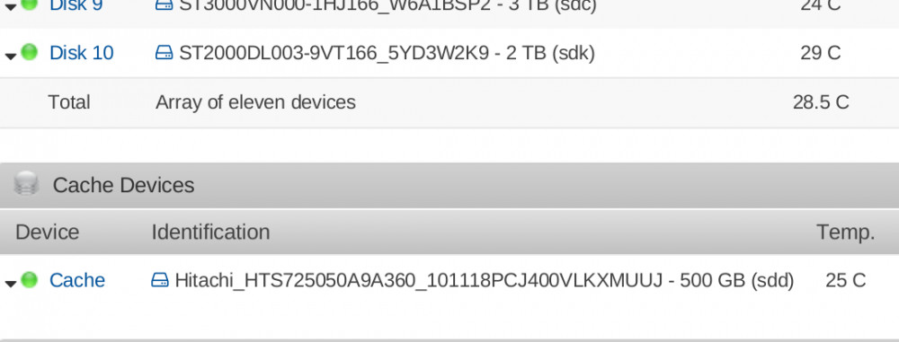

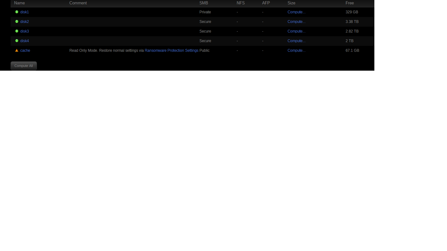

does yours say this, just noticed mine?
That's a typo of mine in resetting permissions via Ransomware protection plugin.  Nothing to actually do with anything unless you have disk shares enabled and directly access the disks over the network.
Nope, i will check the cables, i once tried changing the files system but it did not let me because there was stuff on it. I did do a check on the cache drive in maintenance mode and it passed.
