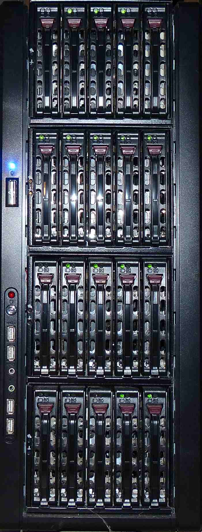

I have a Sharkoon Rebel 12 case. It holds 4 5in3s (20 drives). I have one extra 5in3 that sits on top of the case for 5 extra drives. Works for me.
The Sharkoon case is no longer made (i don't think it is anyway), but might be obtained on eBay. Antec makes a 1200 that I think could be made to support my configuration.

The earlier versions weren't quite as whiz  bang. And if you installed 4x 5in3s, all those blue fans on the front would be gone. But I get you.
My Sharkoon:
