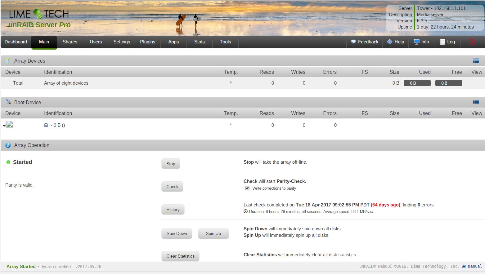

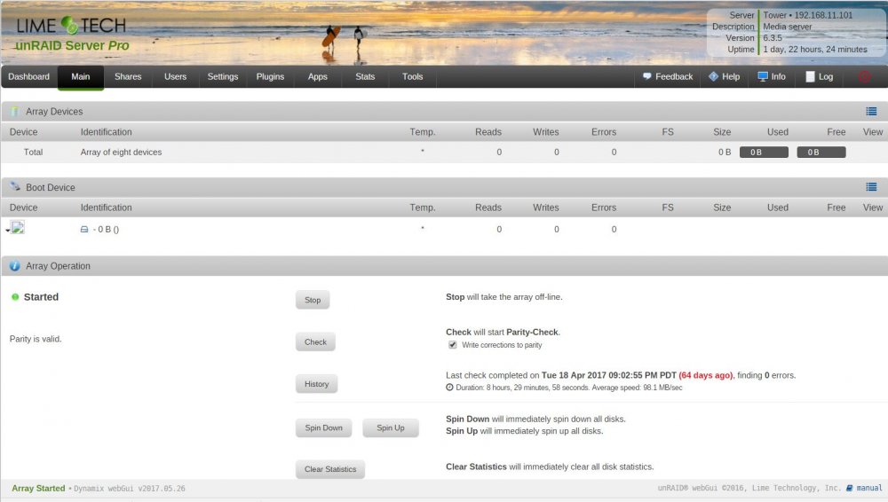

After booting, I can start and access the array without issue. However, after between 1d12h and 2days of uptime, all the disks disappear from the web UI and are inaccessible over the network.  I can, though, SSH into the system, sync and reboot. When the system comes back up, all the disks show up in the web UI and the array will stay up for another couple of days. The cycle then repeats.
I've tried not starting the array to see if that action is the catalyst, however the same outcome still occurs after about 2 days.

Looking again to your screenshot it looks like your flash device goes offline. Try a different USB port, preferably USB2 and see if that improves your situation.

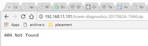

The failure occurred again a short time ago. I cannot seem to get diagnostics in this condition. When I attempt to download them, I get a 404 error.unraid_404.JPG.175375887903bf5b82e5bd82ebe3333d.JPG
