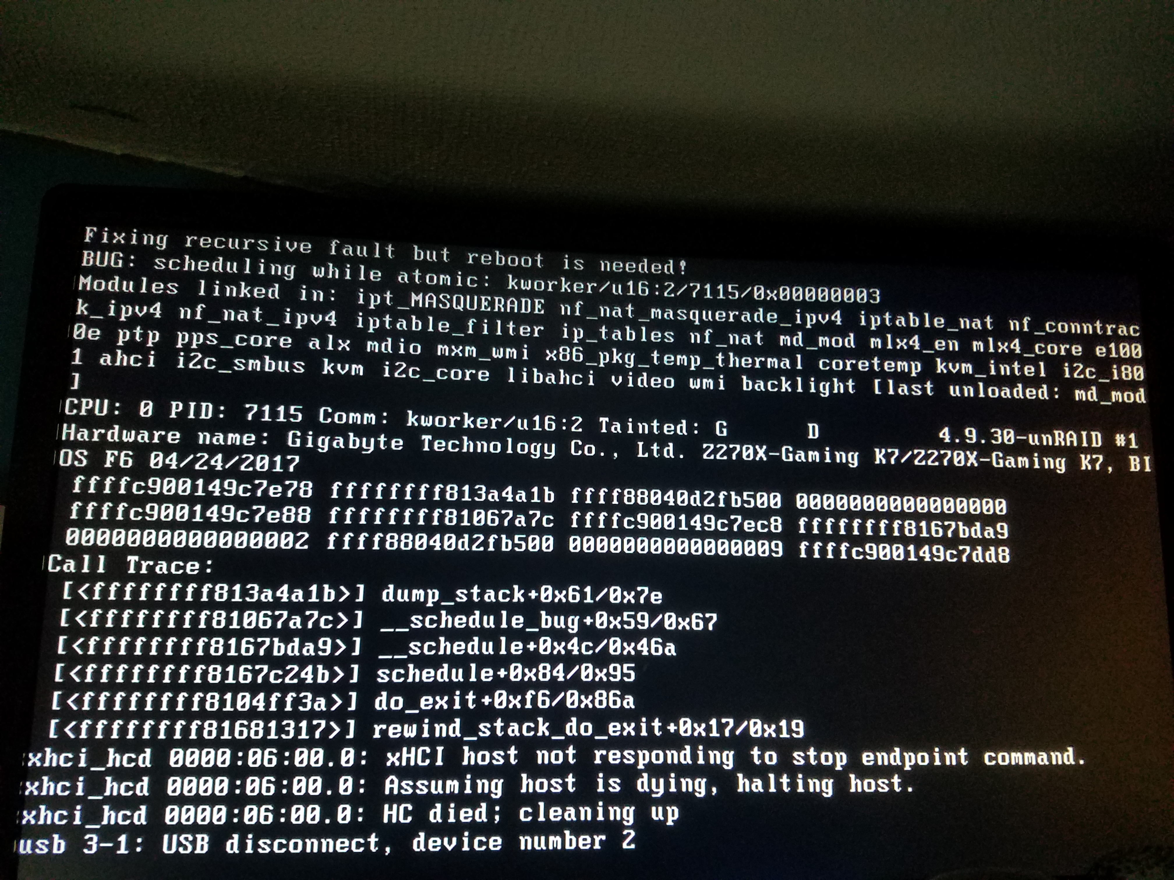

Sorry for the bad quality but i had to take this picture with my phone... This happened when there was no twinax cable connected... you can see it in the error it lists mlx4 which is my mellanox card.... Or i now notice it says usb disconnected im wondering if this is possibly being caused by my thumb drive unraid is installed on? or maybe it was referring to my keyboard since thats the only other usb device connected....
Edited by Hannibal
Or could it possibly be the motherboard since it specifically lists my mobo under hardware name? Im at a very novice level when it comes to linux and code like this so its hard for me to determine the cause of this call trace...
The fact it points out nat, mlx4 and a bunch of networking functions points to a spinlock of some kind trying to access the hardware.  Seems that you are not the only one having issues:  https://www.google.com/search?q=Mellanox+6801-M+crashing&oq=Mellanox+6801-M+crashing&aqs=chrome..69i57.6512j0j7&sourceid=chrome&ie=UTF-8#q=mellanox+6801-m+cable+unplugged
Id return those cards and buy the used ones from amazon or intel cards.  I get the feeling those might be shitty knock offs or they are cheaply manufactured cards with mellanox chipset thrown on.  either way shit seems pretty broke, last ditch id still recommend ubuntu live boot and see if the problem carries over.
