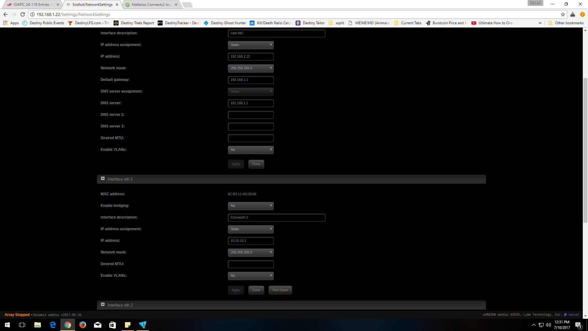

alright, well I've double checked the card i was having issues with that i pulled from my unraid server and everything from that card matches the one that was in my windows machine... so idk why the call trace issues i was having are occurring... I should have pulled diag when it happened but i was locked out of the web GUI every time it happened... if i remember correctly it said something to effect of "dump stack then some code i believe" idk what to do im kinda afraid to stick the card back in my unraid machine in fear another call trace will happen then i will be forced into another parity check by unraid....
I have reinstalled the mellanox card back into the unraid system... I am keeping my array stopped while i monitor to see if another call trace happens so i wont be forced into another parity check... Both cards match up identical in mlxup... so i honestly have no idea what could have caused the issue... I went over bios settings and made sure no power saving features were enabled... so i guess im just going to monitor the unraid pc and see what happens.... Fingers crossed to everything working this time around.... Here is a screenshot just so anyone can double check that i have this setup correctly...

Might want to force a MTU of 1500 just to make sure.  Jumbo frames and 10G can have interesting results!

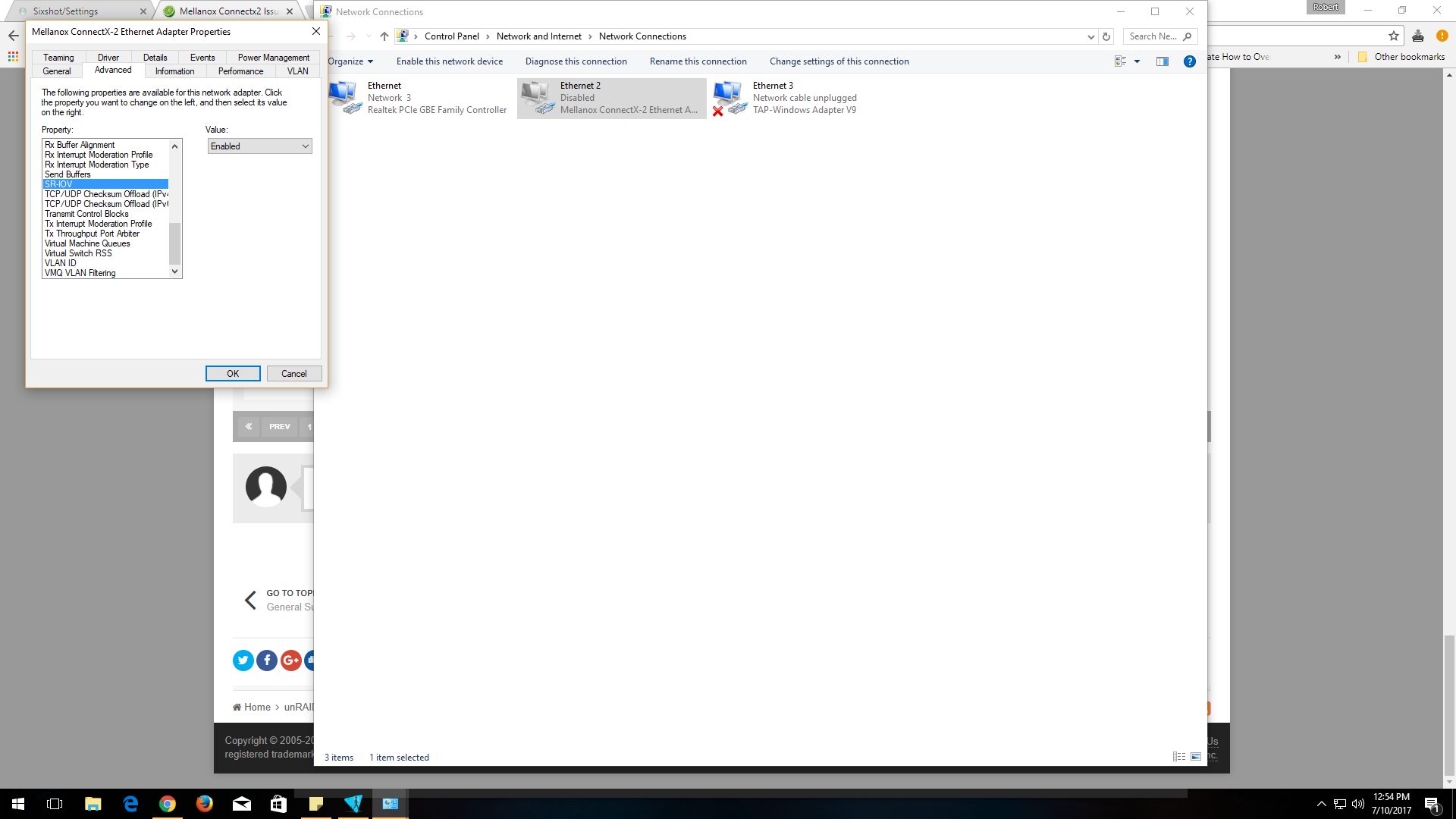

This is where i found it on the card settings in windows and then i noticed the BIOS setting on my unraid server which is using a gigabyte gaming K7 mobo and a i7-7700k... but alright i will try iperf.... I was also thinking about buying a new DAC cable.... should i just purchase another cisco cable or should i purchase a mellanox link X cable?
If you disable from the bios it doesnt matter what the card has enabled, you might want to get some fibre gbics and do away with the twinax, id assume it would be cheaper!

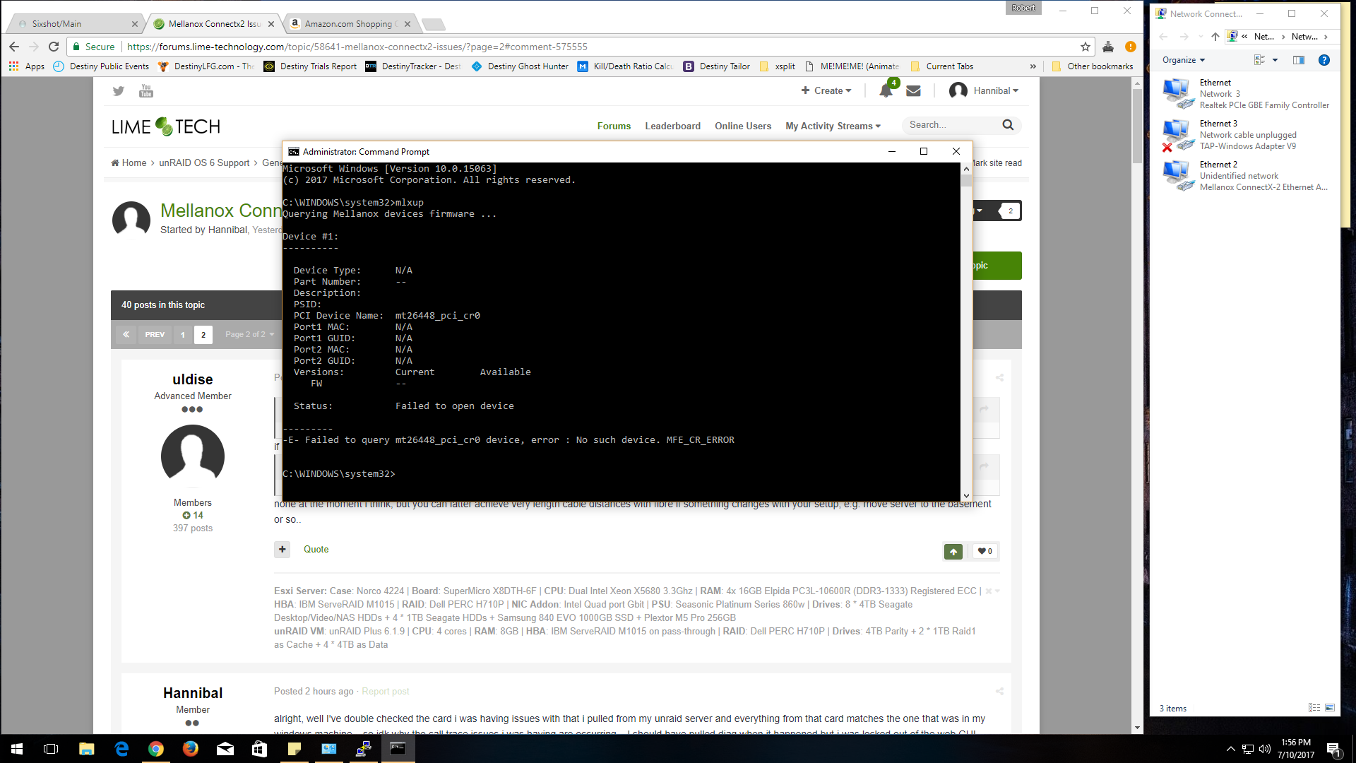

Now its back to a disabled connection... When attempting to query the cards this is what i get...
Did you disable SR-IOV?
Yes it's disabled
