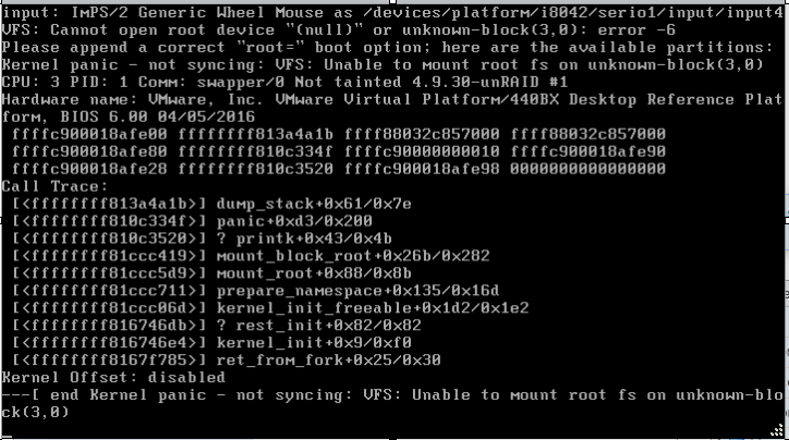

August 19, 20179 yr Community Expert 15 minutes ago, fatpipe said: [/dev/sda1].write_io_errs 8139715 [/dev/sda1].read_io_errs 5920440 [/dev/sda1].flush_io_errs 166432 [/dev/sda1].corruption_errs 73445218 [/dev/sda1].generation_errs 19166 As you can see there are millions of read and write errors, these are hardware errors, usually a bad cable/connection, you can reset then using: btrfs dev stats -z /mnt/cache Then keep monitoring them, counters should all stay at 0 21 minutes ago, fatpipe said: I have to manually power off the VM, pull the USB and either scan for an impropper dismount, rerun the make-boot or sometimes reload the unRAID software and make-boot to get it to boot again. Next down, the same, over and over. What do you make of that? If you're using a USB 3.0 port try a 2.0 port instead, if already USB 2.0 try a different flash drive.
August 19, 20179 yr Author changing flash drive and license binding to USB mean it is not trivial. I only moved the license to this USB back in March or so when I built this. As I say been happening from the get-go so may well be a faulty USB bit. Don't I need Lime tech support to make that change though if it is under a year? On the cache btrfs errors. Yes plan to monitor, that was the count from after the recovery mentioned above. Will doublecheck the USB type of the port I am using but I believe it is USB2. Anything specific about USB3 port problems to cite? The USB I use is a USB2 only for sure and old since consigning it to unRAID meant it would probably never do anything else.
August 19, 20179 yr Community Expert 4 minutes ago, fatpipe said: Don't I need Lime tech support to make that change though if it is under a year? If it's another changer in the same year yes. 4 minutes ago, fatpipe said: On the cache btrfs errors. Yes plan to monitor, that was the count from after the recovery mentioned above. Checksum errors are the result of the read and write errors, and like I said those are hardware related. 5 minutes ago, fatpipe said: Anything specific about USB3 port problems to cite? Many users have issues with USB 3.0 ports, always use USB 2.0
