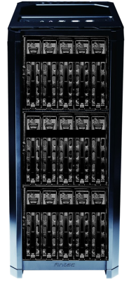

August 13, 20179 yr The Antec 900 and makes a case, and Sharkoon REX8 both have 9 5.25" bays, which can hold 3 5in3 hot-swap bays, like the CSE-M35T-1Bs. Here is an Antec 900 configured like that. And there was a similar recent build with the Sharkoon written up in the forums somewhere.
August 25, 20179 yr The Antec 900 is from 2006... i doubt, you can buy it... Edited August 25, 20179 yr by Zonediver
August 25, 20179 yr Seems that you can: https://www.newegg.com/Product/Product.aspx?Item=N82E16811129021 Edited August 25, 20179 yr by Tybio
August 25, 20179 yr 5 hours ago, bjp999 said: And here is another more modern option. While it is good, I just can't really get into cases that you have to mod with power tools. It does end up being a better case, I grant :). We really do need a new hot-swap solution, I'd love a Define with hot-swap (just spin the cage and give it freaking caddies!)
