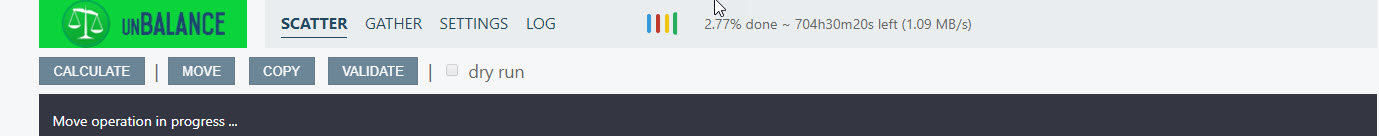

August 14, 20179 yr I have recently installed Unraid and have been working to get everything setup correctly. I have been experiencing very slow transfer speeds while I was migrating data to the array. After some reading on the forum I removed the Parity disks and the write speeds seemed to improve from 2-4Mbit/Sec to 10-13Mbit/sec. I have recently ran the CA Fix Common Problems tool and the following errors appeared. It was recommended I post the diagnostics to the forums. Can anyone please assist? On another note I am trying to run unBALANCE for the first time and it is running at 1Mbit/sec, slower than any transfers I have had since I started. diagnostics-20170814-1215.zip
