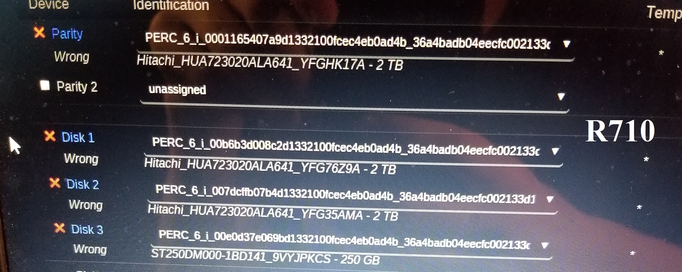

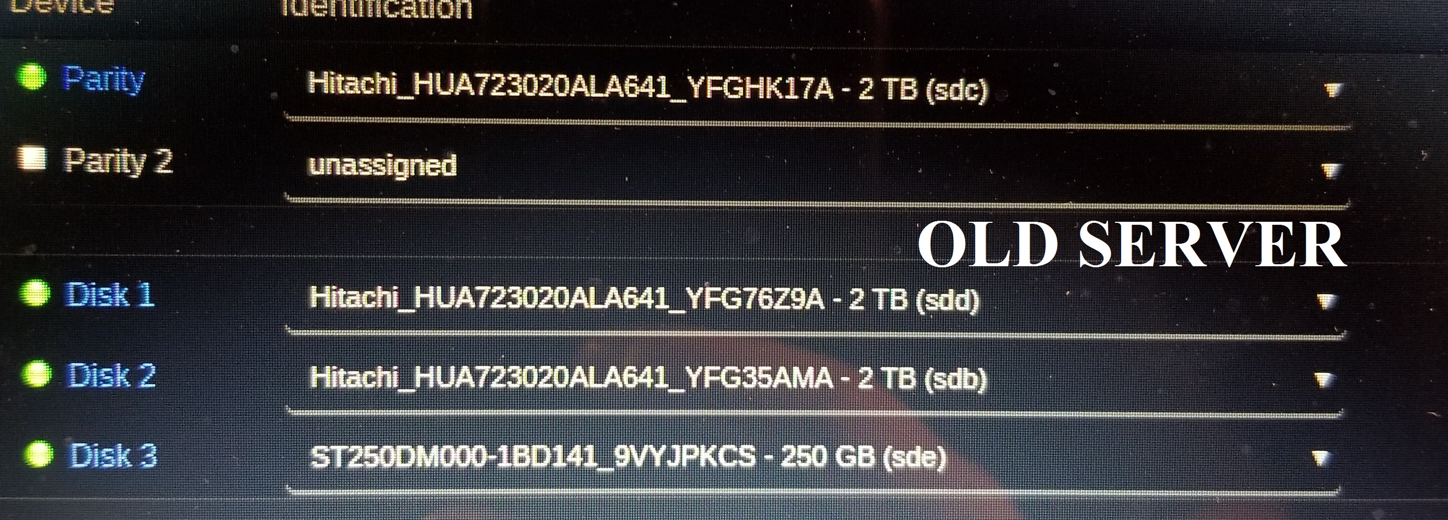

In my brilliant mindset, I went ahead and tried to just swap the drives entirely. I moved the 3 2tb and single 250gb drives from the old machine into the r710, took the flash drive and plugged it in, made 4 raid 0 arrays with the drives, and booted into unRAID perfectly! One issue....... Making the raid arrays destroyed the tag for the drive, and i'm assuming it masked its serial number too, so unRAID had no idea what to do with "4 new drives" and assumed I had lost my 4 drives (see pictures attached). I have been looking for days for a solution to this annoying problem, but to no avail. The drives are back in the original server at the moment and is working fine. Does anyone have ideas on a way to go upon switching out these machines without starting over from scratch? Thank you for taking the time to read over my craziness. I'm willing to experiment, and have the resources to do so. I just am worried sick about loosing the information on the drives. A backup has been taken in preparation.

2 minutes ago, bonienl said:
Try the Dynamix SCSI devices plugin and see if names change.
I'll give it a shot today! Thank you for the quick reply. Do it with the drives in the R710 I presume? Or do it before the switch?
Thanks!
- Koby
Or, take the easy (correct?) way out and swap the PERC6 for a controller that doesn't mangle the ID or require jumping through hoops. Plenty of options available for $50 and up. LSI based controllers are best, don't use Marvell based controllers. Search the forum for LOTS of discussion on good controllers and good deals.
I'll look around. Haven't done much research on replacing it entirely. Although that is probably the best, and correct solution. I'll check it out, thanks!
Thanks!
- Koby
Just install the plugin on your new machine.
Would also consider the LSI option, this is proven to work.
