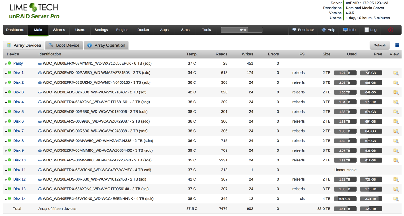

I started to follow the instructions pinned by bjp999 (https://wiki.lime-technology.com/File_System_Conversion), set the new drives FS to XFS after excluding it from the User Share, restarted the array, but even though it does show as unmountable, as predicted, there is no Format button present (see attached screenshot).
What could I have done incorrectly to cause this? Do I need to remove that disk from the array's configuration first? I didn't see that as a necessary step in the instructions. What could it be?
since the instructions and my situation differ in that the instructions *add* a Swap drive to the array, while I set an already existing array member to XFS before restarting the array, am I correct in thinking that I first have to remove Drive 11 from the array? would I then have to create a new confirguration?

If you want to force a format operation on a disk, then change its file system. You may need to change the file system first to something else if your desired files system is already set.
After each file system change you need to start the array to make unRAID aware of the change.
And... formatting a disk will erase any data on it!
