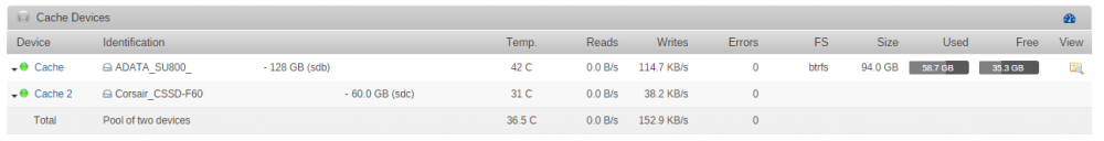

September 1, 20179 yr Hi All, I am new to unRAID, but love it so far! I have been setting up my personal server for the last few days and have it setup almost completely. Assuming that cache disks work in the same way the arrays do, I added an old 60GB SSD (Cache2) to the existing Cache (128GB SSD). Only then, did I notice that they were being pooled... They appear as a 94GB BTRFS pool (which is less than it was with one drive). This was a terrible decision on my part as this drive is much less responsive (it is old) and now I have less cache and a slower drive. I would like to go back to the way it was, but I know it is not simple as that. I really don't want to damage anything, so please advise how I can remove the 60GB drive from the pool without messing up anything. On a related note, I do not have a parity setup yet (I was going to do that at the end after I added all of the disks). Please let me know if this can cause an issue when I remove the second Cache drive... Thank you! - lankanmon Edited September 1, 20179 yr by lankanmon
