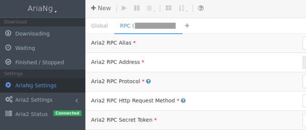

September 17, 20179 yr Hey Fanningert. I installed this app but it seems im probably missing a step. WebUI keeps throwing an error Quote Oh Snap! Authentication failed while connecting to Aria2 RPC server. Will retry in 10 secs. You might want to confirm your authentication details by going to Settings > Connection Settings Is this just the aria2 webui and i still need to install and configure Aria2 separately?
September 17, 20179 yr Author @robw83 The solution is in my first post of this thread. But you are right, in the package documentation, this step is missing. I will add it. Thanks for the information. The only step you need to do is configure the RPC setting in the connection section (Settings -> Connection Settings) of the webui and enter the host, port and your SECRET. When I find a solution, I will let change this settings over the docker settings. Edited September 17, 20179 yr by fanningert

February 16, 20188 yr Hi, Can you add also this new gui for aria http://ariang.mayswind.net? Maybe on another port? Or create a new docker? I think this one is better... Thanks.
February 18, 20188 yr Author @Chad Kunsman, @thomas, @pinion I created two extra docker and updated the current docker container. All three supporting PUID (User-ID) and PGID (Group-ID). aria2-daemon = Only the Aria2 daemon (Docker-Hub: https://hub.docker.com/r/fanningert/aria2-with-webui/) aria2webui - Aria2 daemon and webui-aria2 (Docker-Hub: https://hub.docker.com/r/fanningert/aria2-with-webui/) aria2-with-ariang = Aria2 daemon and AriaNG (Docker-Hub: https://hub.docker.com/r/fanningert/aria2-with-ariang) All three docker having the same aria2 configuration structure. Support pages for the new docker container, better icons for this three container and a support page update for this container, are coming later. Extra information: The docker aria2webui is working, but the current master version of the web app has an error. So you will not see anything. I opended a issue for this problem https://github.com/ziahamza/webui-aria2/issues/437. <- Is corrected Community app entries are updated. So you should see it after the next scan job. TODO: Support of HTTPS for web frontend Edited February 22, 20188 yr by fanningert

February 25, 20188 yr @fanningert Actually was wondering if there were technical limitations to having the AriaNg GUI's changes not be able to be persistent. There are a lot of configuration options there, and they are convenient to adjust. But I must assume that there are reasons why setting them there does not 'permanently' change them for the docker container.
February 25, 20188 yr Author @Chad Kunsman AriaNg changing the current arai2 session parameter and not the aria2 global config file parameter. So the AraiNg is not persistemt. But you can change every aria2.conf over the docker web ui or aria2_ext.conf.
