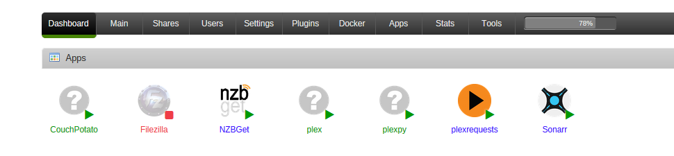

September 22, 20179 yr This is going to sound really odd, and I have been unable to work out what is going on so hope someone can help me. Firstly I will say that unRAID is (and has been) running really well for me. I have a simple setup which is an HP MicroServer with 4xHDD (3d+1p), 1xSSD (cache) running unRAID 6.3.5. Today when I was starting my periodic updates (docker image updates & plugin updates) the unRAID gui started being really unresponsive. All of the docers run fine, share access is fine but any time I try to load a page in the unRAID GUI which shows anything to do with Docker images it takes AGES for the page to load. Most pages load in <2 seconds, ones with Docker stuff on (e.g. Docker or Dashboard) well over 2 minutes. I rebooted the server with a clean shutdown of each docker image, stop of the array, etc. and all started back up fine (although maybe slower than normal) so thought I would ask the question. I am seeing some odd display of the docker images (missing icons - see screenshot) and have attached a diagnostics in case this helps. Anyone able to point me at what may have started causing this? it is a real pain waiting for the ui to load when checking things. davidserver-diagnostics-20170922-1822.zip

September 24, 20179 yr Author 18 hours ago, markiii said: in the unraid network settings, I too could resolve and ping fine from an unraid console Thank you. I had my doubts but the server was quiet enought to stop everything this morning, the DNS is now 8.8.8.8 and 8.8.4.4 and everything is working at full speed. I really wonder what Sky broke in their DNS resolution but will leave my curiosity alone for now
