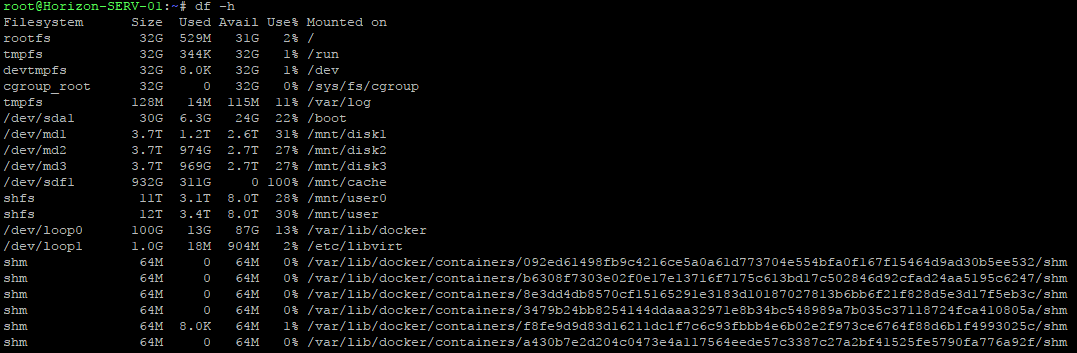

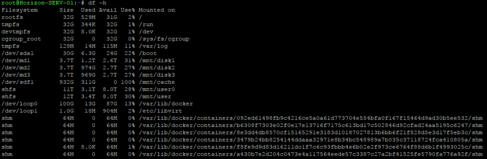

I have been using unRAID for about a year now, and just recently started having this issue. I am running 2 Ubuntu VM's on unRAID, one of which is constantly downloading data to /mnt/cache/ and the other is a DNS server. The one constantly downloading data will occasionally tell me that the disk (/mnt/cache) is full and stop downloading. I will SSH into the server and run df -h and see this output:
/dev/sdf1       932G  296G  637G  32% /mnt/cache
And the unRAID webUI says the same thing, but it will still tell me that the cache disk is full. This is also causing an issue with my DNS server, because it will randomly pause the VM it is running, making me open up the webUI and resume the VM every time. I have also attached a screenshot I took a few days ago when having this issue where it says that my cache disk has used 100% with over 500gb free. I have also uploaded my log file.
