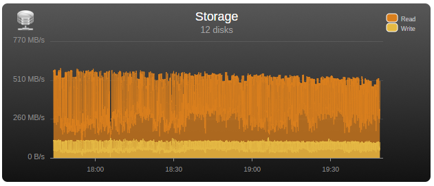

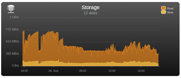

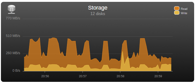

I've added a parity drive, and it is currently doing the sync for the new drive. The overall speeds seems to me to be decent at about 70MB/s (should I be expecting more?), but with the system stats plugin I get this view:
Is this normal? It seems the overall speed is going down as I'm nearing the inner part of the drives, which I understand is expected. I'll be running some tests on the drives and the tunables tester after the parity sync to see if anything seems wierd.

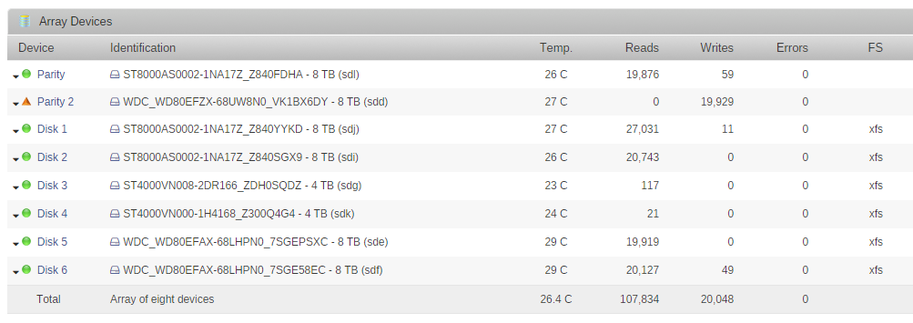

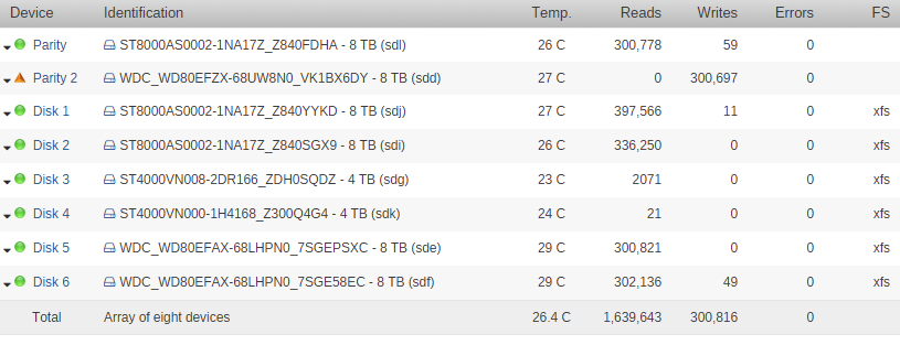

Here is also a view of my drives:

Here is the past 5 minutes after clearing stats.
4 minutes ago, Fredrick said:
"Clear statistics"? As in the reset button in the stats page?
"Main" page which near bottom "Clear statistics", thanks
This is after a couple minutes (do you need exact time?)
Currently one stream going to Plex, apparently from Disk 1. Also Parity sync is at 97,6%, so the 4tb are done.
I suppose there should be no any write in parity/disk1/disk6, but I may be wrong. I think you should focus on this.
If you don't mind stop current parity2 sync, you may stop it and start array in maintenance mode and check speed uniform or not. ( In this mode, STATS plugin won't work )

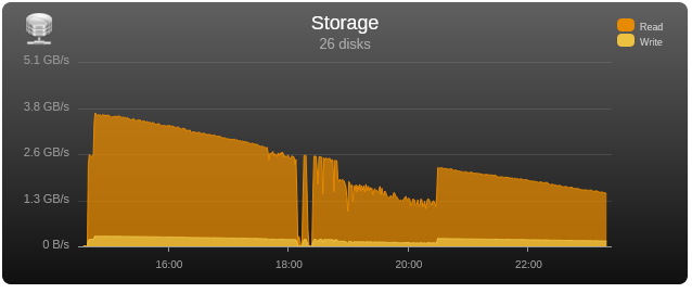

That is all over the place, strange pattern, possibly a disk with slow sectors, but they usually look more like this when that's the problem:

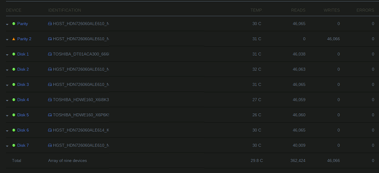

Would you open another browser page ( main and stats ), try to check does those drop happen in each write ( exclude parity2 )
Trying simulate parity2 sync, no any write on other disks :x
Yes, as I said its fairly unstable. I should probably have opened with that graph instead.
Does not seem to be the problem. I'm still seeing a lot of spikes between about 450MB/s total read and 150MB/s total read.
There has been no other writes to the array/parity since i cleared statistics almost an hour ago.

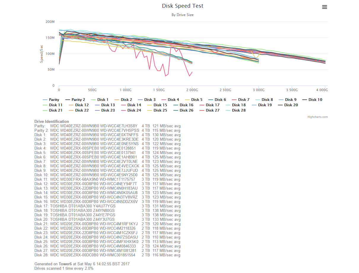

Diskspeed plugin is the best way, make sure you select a lot of sample points, example of a disk with slow sectors:
59cd5a737cef3_Screenshot2017-05-0616_31_13.thumb.png.e42762b72e2e25cf71daf6cdc920739d.png

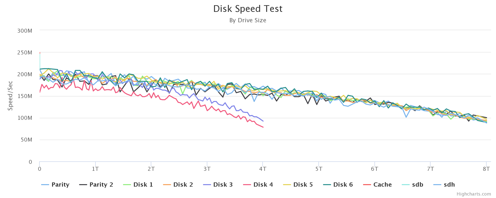

Well, here are some more odd results. Please note, this is with the array started, I'm running further tests now with it stopped. Currently running 2% slices on all drives in normal mode with array stopped.
Cache drive and the unassigned "LOGICAL VOLUME" are attached through the internal raid controller in my Proliant (no S.M.A.R.T. available). All other drives are via the LSI card and in the same EXP3000.

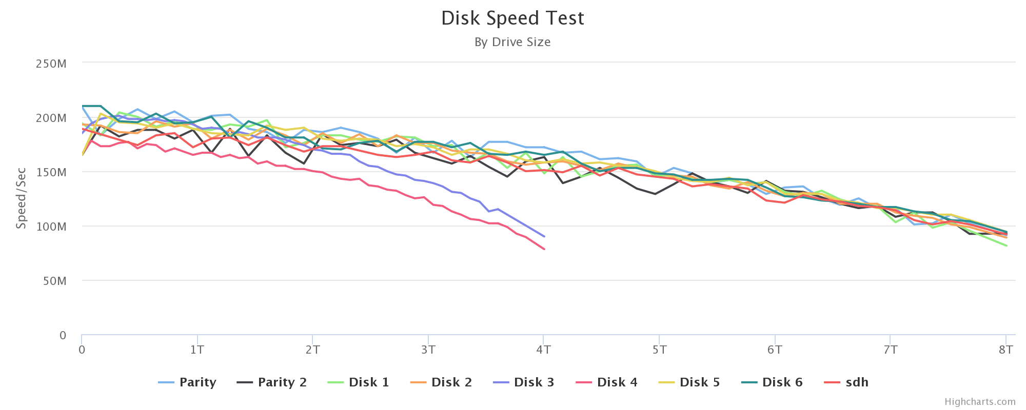

This is normal mode, and with 2% slices.

Now first of all I feel these lines are all "jagged", but no clear drive with bad/slow sectors. The average speeds seems decent overall with disk 4 lagging behind a bit.
Secondly. What is going on with my SSDs? The Cache and Logical Volume (both Kingston SSD Now, 240gb and 120gb respectively) show 228/229MB/s which is very low. Furthermore they seem to start and stop at 0gb. I'll test this some more aswell.
And third, my parity 2 drive seems to be slower than my other Reds, and has a much more jagged look than the other drives.

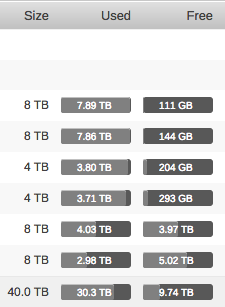

One more bit of information. Several of my drives are very full. Could this be a problem? I read conflicting reports, and until recently my array was pretty full overall. I could move some data around if that can help these speeds.
59cde51c559ab_ScreenShot2017-09-29at08_15_52.png.aec1d5c3ffe093fc93b227f2dc94d09b.png
