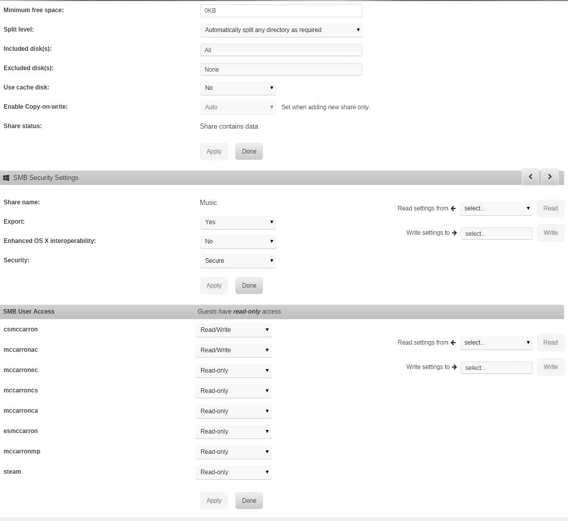

I wanted to grant a user Write access on a Secure Share.  So I granted the user Read/Write permission on the share and applied the changes.  The user was still unable to create files/folders on the share.  I then looked in the smb-shares.conf file and noticed that the "writeable" property was set to no.  When I tried to turn this on for the share I notices it was no where to be found on the UI.
Was this removed on purpose?

The user and password match on both the unRaid server and the PC.  I turned the writable option off, and even though the user is listed as having write access the user cannot write to the drive.  I have also reboot the user computer and restarted the samba server on unRaid.
So if when using a Secure share granting user write access is suppose to work, all I can say is it is not working.  There are two user with write access on this share, myself and 1 other user.  I have write access the second user does not.
I did discover that turning the writable option on, enables all user to write to the drive.  I do not desire that so I turned that back off.
The share in bold is the one not working.

Is the Games share working correctly?
No
The logins for the two users are from different computers, right?
Yes

Shit, I know what the problem is, and it is not the unRaid OS, sorry.  The user name on the PC is mccarronacx01 instead of mccarronac.  My script uses the USERNAME environment variable to connect the drive.
I feel dumb, DAMIT I hate when that happens!
