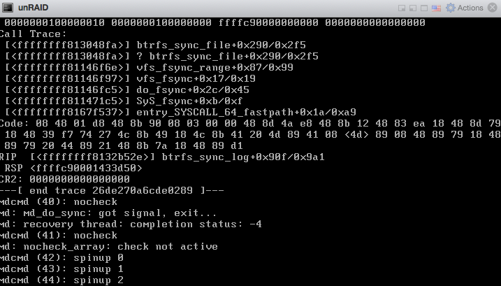

October 19, 20179 yr Author Ok, so some good news... I got my second ESXi box up and got my firewalls working in HA mode. I brought up the unRAID VM (on the other ESXi server) and had a few minor issues (it seemed to have lost my shares, which had happened before on physical hardware - rebooting seemed to fix it). I have had a couple of backups go to it now without trouble, but I ran into a problem... When I try to add a docker container, I'm getting this: Error: open /var/lib/docker/tmp/GetImageBlob652775487: read-only file system I'm running two 3 TB drives for storage with a 4 TB drive for parity and two 250 GB SSDs for cache. These all connect to a 9211-8i with IT firmware, version P20. It appears that the one docker container I was actively using (Plex) is stuck updating the EPG... I imagine this is related. Edited October 19, 20179 yr by Taige
October 19, 20179 yr Author Ok, I backed up my appdata, removed my cache drives, ran a pre-clear on them, added them back, formatted them, restored the backup, added a docker, and all looked good. Then I edited a file from my appdata directory (to set my DDclient up) and tried to restart the DDClient docker, only to get errors. Now, if I try to add another docker, I get this again: Error: open /var/lib/docker/tmp/GetImageBlob019683831: read-only file system
October 19, 20179 yr Author I may have figured something out... I used two different types of cables from the 9211-8i. One of them came with another server. Another one was a third party cable I ordered online. One of the cache drives is attached with the cable from another server, and the other is the new third party cable. To see if it was related, I removed the cache drives, then put back a single drive, one that I think is attached with the original cable (from another server). It's only been a few minutes, but so far everything is fine. Can a bad cable cause this sort of symptom? Thanks, Paul
October 19, 20179 yr Author More info... Things seemed ok for a while, so I stopped the array, and tried adding the other disk back. At that point, VMware crashed. So, I'm thinking it's a cable or drive problem... Anyone have any known good source for the breakout cables to connect to a 9211-8i?

October 21, 20179 yr Author It looks like it's having trouble even with only the one Cache drive (though not to the point that the system crashes, like it was doing)... I'm having strange issues related to my cache drives, specifically my Plex docker... So, I've decided to remove this Cache drive as well to see if that will stabilize my docker situation... .... BUT... Reading your sig made me think of another idea... Move both of the SSDs to the ESXi server itself, and add them as Datastores, then create two virtual HDs as cache drives, one on each SSD. That would give me the benefit of backup for cache, and the side benefit of having SSD speed storage space available for other VMs...
