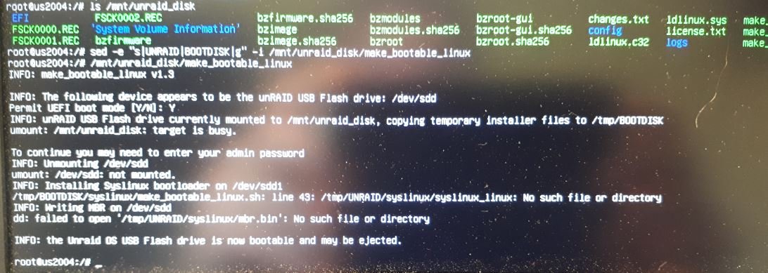

So tried again with method 2 and g flag in the sed command.
Still errors in the make_bootable_linux command, as follows:
In my case:
sdc is the source USB - called UNRAID
sdd is the new target USB - at this moment called BOOTDISK
Target USB still not bootable.
In my case:
Yes, so much for just reading the code and not testing...
The "make bootable" process has changed since those instructions were written, so that some more adjustments are in order.
Try this, in addition to previous edit (again, just offhand looking at code, no time to test right now):
sed "s|UNRAID|BOOTDISK|g" -i /mnt/unraid_disk/syslinux/make_bootable_linux.sh
Then run make_bootable_linux again.

It worked, but differently - still a lot of thanks to thohell for the bzoverlay and the initial idea.
Note: the make_bootable_linux installer itself does not work!
So I did it using Windows, as follows:
- Using the terminal of the server itself to download the bzoverlay file to /boot, with the wget instruction.
- Backing up the flash drive (and thus already with the bzoverlay).
- Extracting the backup.zip to the new flash labeled BOOTDISK
- Modifying the make_bootable.bat; replacing UNRAID by BOOTDISK (only once for tag)
- Running make_bootable.bat (as admin)
- Modifying syslinux/syslinux.cfg; replacing all instances of /bzroot by /bzroot,/bzoverlay (except /bzroot-gui)
- and then of course, changing the bootsequence in BIOS.
Basically that's it.
Detailed instructions I would have also.

Just out of curiosity - can you share what happened when you tried to run make_bootable_linux after doing both "sed" edits?
I guess I was a little bit too quick, because when looking at the logs, the following is repeated every 3 seconds.

As to make_bootable_linux.
I went back to the basics and just tried it without any changes and the USB did not boot, so then I stopped going with the linux method.
I could try it again just for the sake of the messages, but most or all had to do with mounting and unmounting.
Yeah that won't work.
I just tried it on my prod system (shudder). It seems to be doing the right thing (on the right disk...) although it does spit out one error message re unmounting - I believe this is a bug in the original script, has nothing to do with this exercise - but it does seem to work; I have not tried to boot from it (as I said, my main system), may try later.
If you're in for the game, you may want to try it - the process will be more streamlined.
