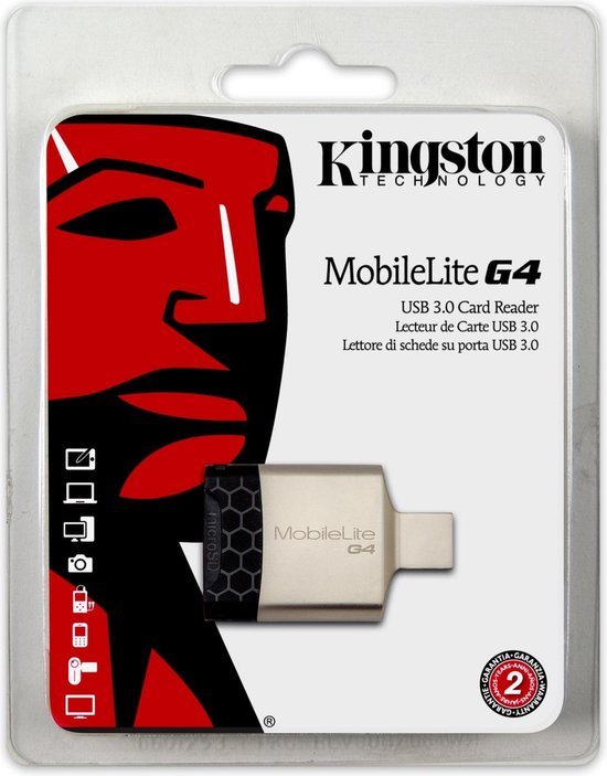

Incidentally, a different way to solve the issue as you're framing it is to use an USB Card Reader instead of a USB stick. Some of the card readers have IDs that can be used by Limetech's licensing scheme. If the flash component (an SD card of sorts - usually a microSD) wears out, you just pull it out, install a new one and restore content from backup. ID remains the same so license remains intact.
You can find out more about this here and here.
About the card readers; yes I know, I tried that then with below Kingston MobileLite G4.
But blocked as no unique GUID. Then I didn't try anymore.
Yeah, I'm using the G2. Old, can sometimes be had from ebay, but does have a solid GUID.
