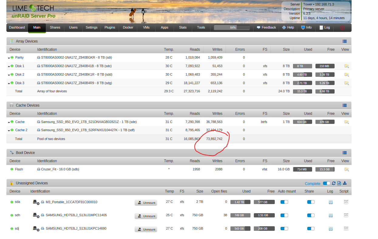

74 million writes to SSD cache in 11 days. Is this normal?
My server is fairly busy, and I had a 1TB Evo 850 cache drive fail on me in less than a year. Admittedly it had spent several months having CCTV written to it at approx 5MB/s.

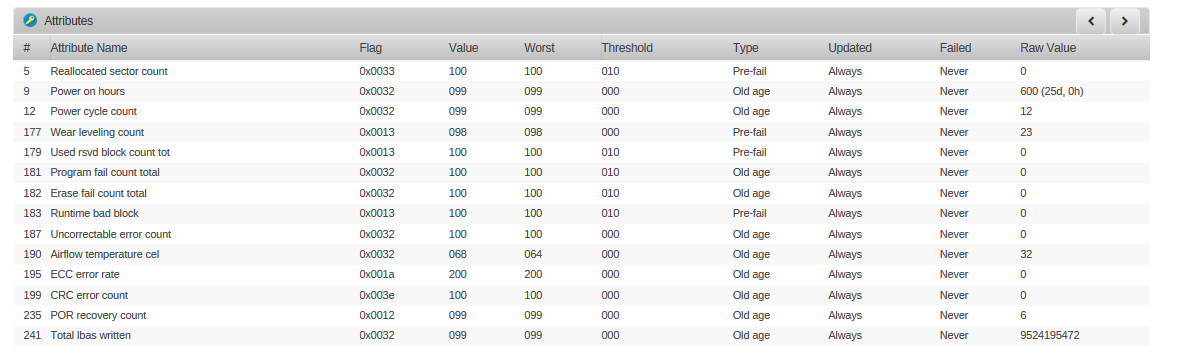

Here is current data for my new 1TB ssd which was put in about a month ago. 5TB written to it. If I assume 1TB was the inital build so 4TB per month.
Samsung website say they are guaranteed for 5 years or 150TBW. So at this rate I can expect the SSD to run out of warranty in 3 years time.
I'll check again in a couple of days to see if the difference matches up with the 4TB per month.

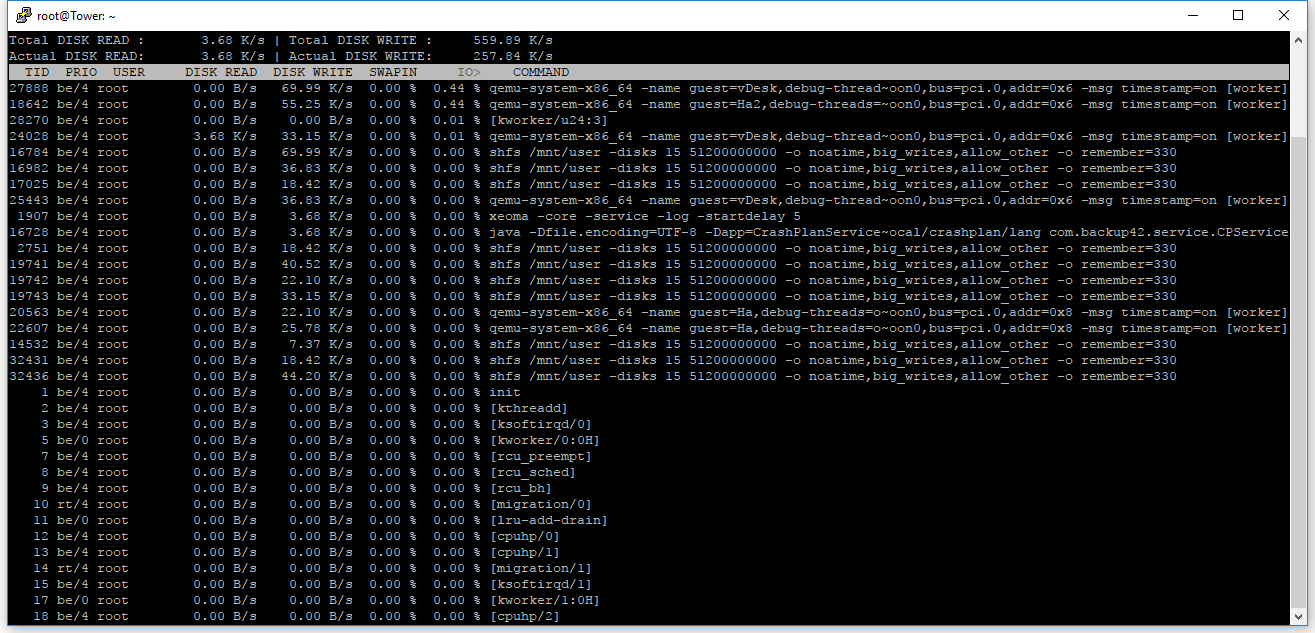

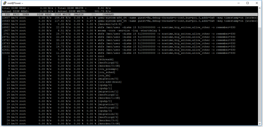

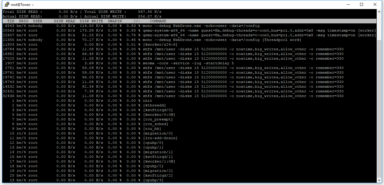

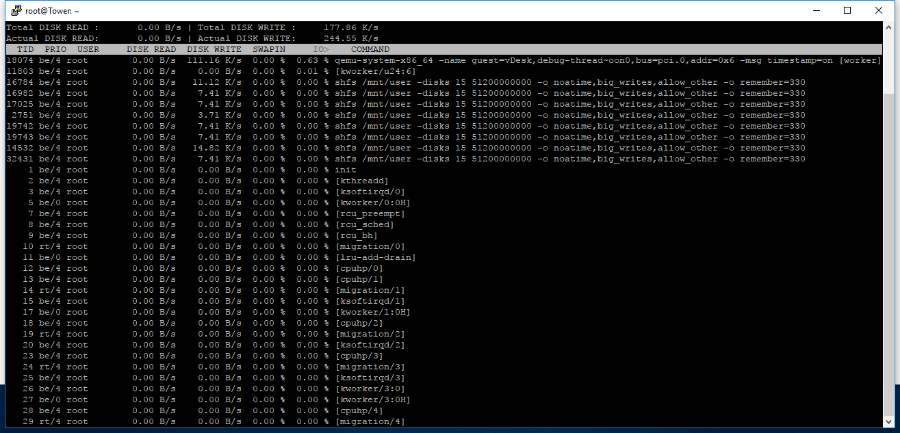

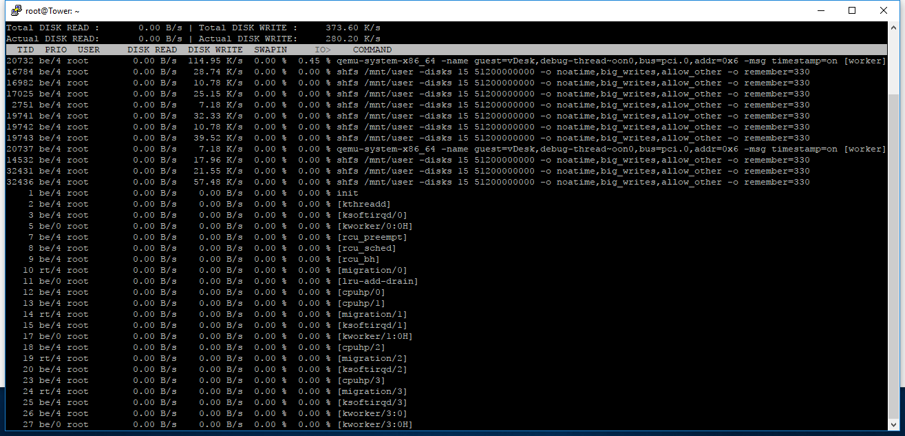

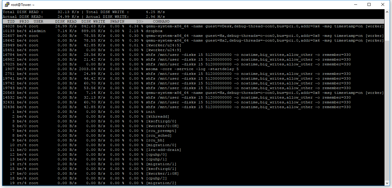

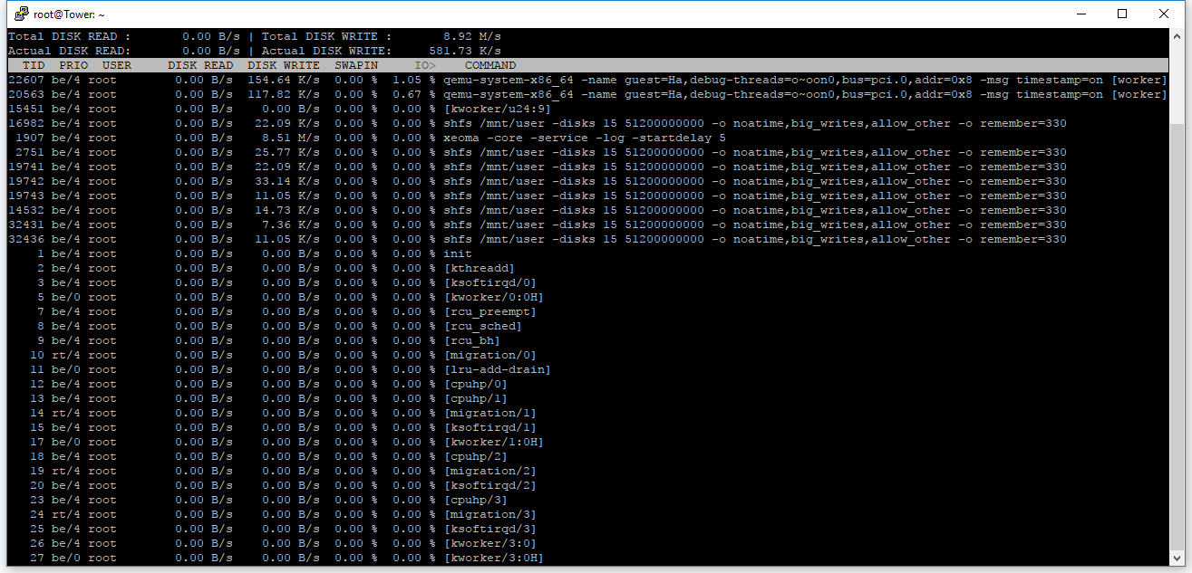

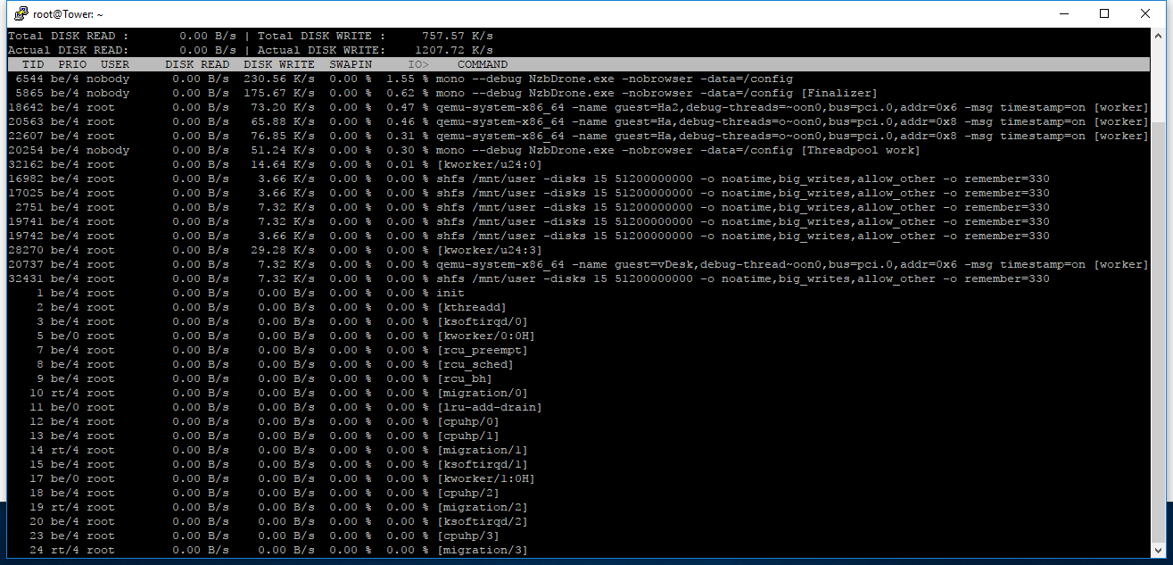

Here are a few iotop screenshots. The Xeoma writes are (should be) to an Unassigned Device, not the cache. Hmm, I assume it writes directly to that device and not to the cache 1st.

I've dug into iotop a little and now have it running showing accumulating values.
The following is a paste of the top few threads after running it for about 30 minutes. These entries started all at once incremented up to this value over the course of a few minutes, and then stopped. It happened the hour before as well.
Cron is set to run hourly jobs at 47 minutes past the hour, so I don't think it is being triggered by that.
How can I find out what it is? I am unsure whether this is showing a total write of 5.8GB or a total write of 5.8GB on each line ie. 60GB.
