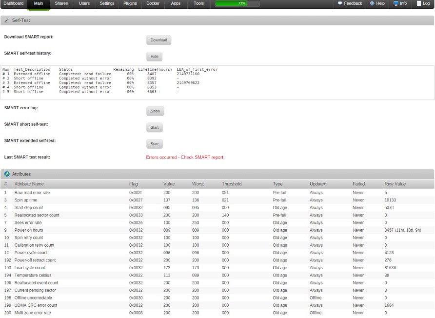

Attached is an image of the SMART page in unRAID for this drive.
So I am wondering how this is possible?  I have an old WD BLACK 2TB hard drive that is clearly having problems.  I have run two extended SMART tests on the drive both of which have failed at 60%.  The first test failed with LBA of the first bad sector at 2149769622 and the second SMART test failed with the first bad LBA at 2149731100.  So clearly this drive is failing.
To run the tests, I have the drive attatched to unRAID via "Unassigned devices."
That said, I thought after the first SMART test I would try and run a preclear to see if the drive could remap the bad sector(s) and see if the drive is potentially salvageable.  However, both preclear operations completed with 100% success with 0 reallocated sector count.  For preclear, I used gfjardim - 0.9.4 with the full "clear" option.
How on earth is it possible that this drive can pass preclear when it is clearly failing according to SMART.  The drive also gets stuck on reads or writes at times so I am pretty certain it is bad.  This has really shaken my confidence in preclear :(

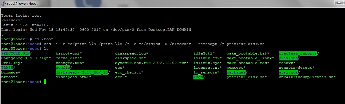

OK, I did not get any feedback from the patch when I ran it so I guess something is wrong (I ran the patch
sed -i -e "s/print \$9 /print \$8 /" -e "s/sfdisk -R /blockdev --rereadpt /" preclear_disk.sh while at the command prompt in putty).  As you can see, I did CD into my root directory where I placed preclear_disk.sh way back in the day.  I did also copy and past the line in putty for the patch rather than typing it by hand.
That said, I am using the preclear gui now so perhaps preclear_disk.sh is someplace else in unRAID 6.x?  I looked through the directories on my flash drive and did not see it anywhere else.  Is there a way to patch the gui or just the command prompt?  FWIW preclear_disk.sh on my root shows that it was indeed modified today, and I installed it a long time ago before there was a GUI version so I think the one in my root is the new version with gui interface.
I could try running at the command prompt and see if it goes, but I don't know the command parameters to specify if it uses "gfjardim - 0.9.4" or "Joe L - 1.15."

OK, I found the new preclear at:
cd /boot/config/plugins/preclear.disk
I ran sed -i -e "s/print \$9 /print \$8 /" -e "s/sfdisk -R /blockdev --rereadpt /" preclear_disk.sh but still got no feedback from the command.  However, now Joe L - 1.15 is indeed working in the GUI :)

Please note in the above posts that I had pre and post read enabled on all preclear operations.  So as far as I know, all sectors should have been read twice durring each preclear operation.
Thus I still have the same questions, how can preclear NOT have triggered bad sectors when the extended SMART tests show specific bad LBA's?

What I find strange is that the SMART log mentions sector failures - the second run fails slightly earlier.
But the image of all SMART parameters doesn't mention a single sector reallocation. Parameters 5, 196, 197, 198 are all zero. With the exception for the log entries, there is no counter in the SMART data that indicates any problems.

It is very strange.
I assumed that the earlier LBA location on the second SMART test was due to more bad sectors resulting after the first SMART test.  Perhaps that's not the case and there is something else failing in the drive (as you mentioned) that manifests as a bad sector in the SMART report.  That said, I find it strange that both extended SMART tests failed close together and at 60%.
The drive is clearly having a problem because it was causing my Windows PC to lock up with a solid HD LED occasionally.
