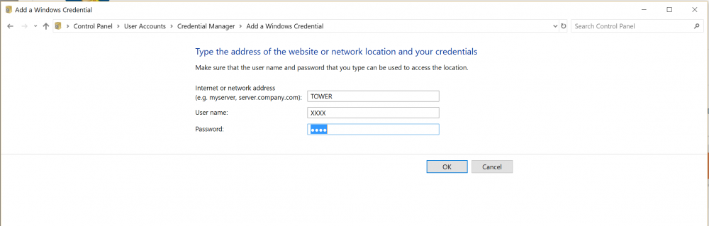

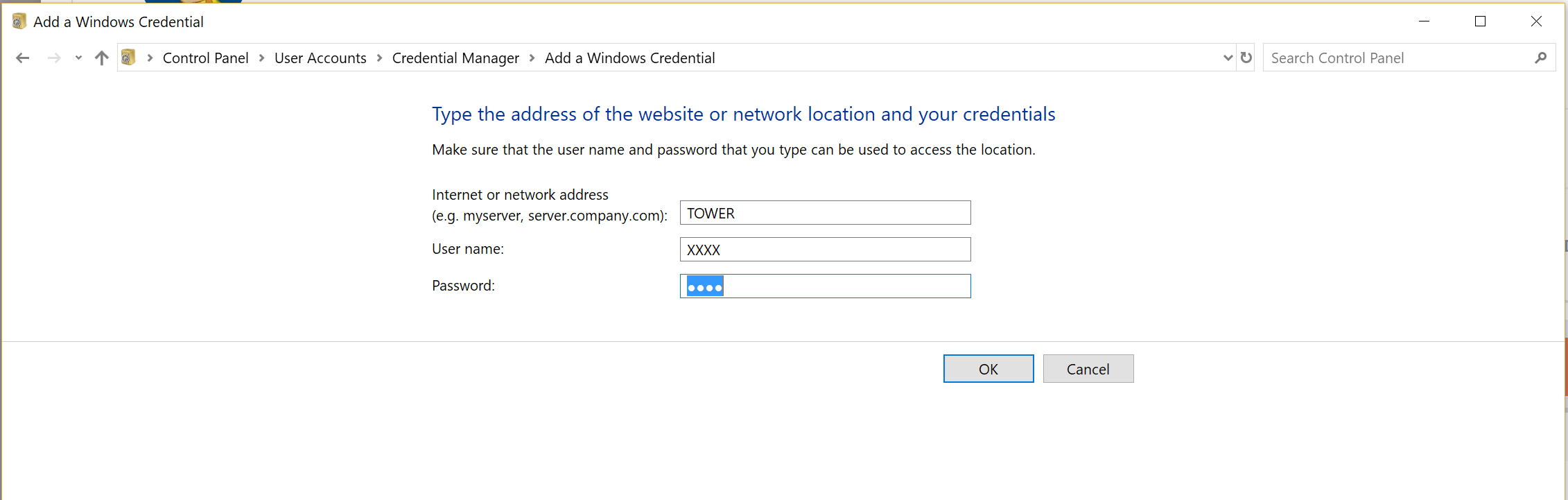

July 5, 20188 yr Hi all, I had same issue and It got fixed easy with below changes: Go to Control Panel Go to Credential Manager on each Windows 7/10 machine on the network Under Windows Credentials, type in the name of each machine, username and password And It's DONE.
