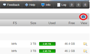

There's a toggle to show real-time speed for all array and cache devices:
Ah, that'll probably work!  Thanks!!

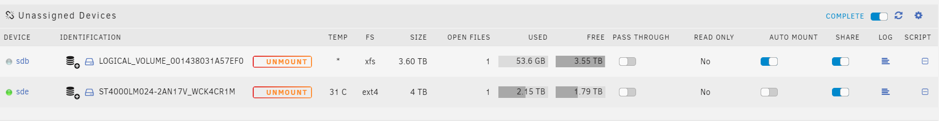

Hi
Is there a way to do the same for Unassigned Devices or some app?
