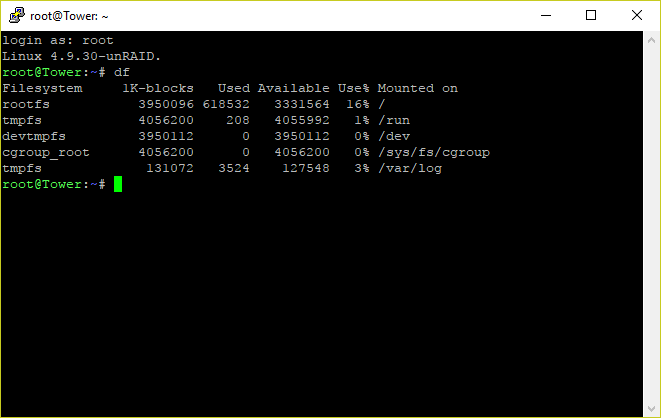

I've attached the df command below.  I'm seeing directories but not sure if they're on the thumb drive?

The ‘df’ command shows that the USB stick has not been mounted.    There should be an entry for /boot (typically with device /dev/sda1).   Quite why this is happening I am not sure as you seem to have checked for the obvious culprits.
you could try manually mounting the USB stick as /boot and then re-running the diagnostics to get the zip file that may give those perusing this thread some idea of what is going wrong.
