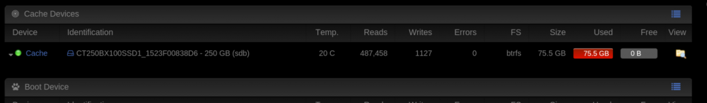

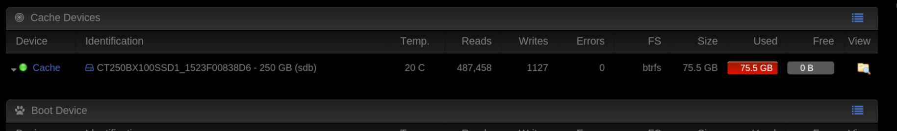

...appears that the size, although being 250 GB in the description is 75.5 GB in the report.
That looks wrong, post your diagnostics.

That issue is not balance related, it's juts space being incorrectly reported, and it will only affect Samba transfers, i.e. locally you'll have no issues, the problem comes from here:
Filesystem      Size  Used Avail Use% Mounted on
/dev/sdb1       233G   71G     0 100% /mnt/cache
As you see the total size is correctly reported here, but not the free size, btrfs has some quirks including free space reporting sometimes, if you don't plan to use a pool and don't care for snapshots and/or checksums might as well use xfs.
