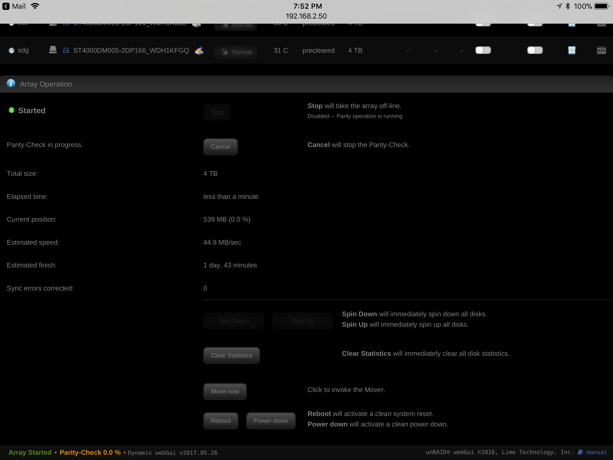

I have it setup and it seems stable for the last 25 days so I purchased the PRo version last night.  I'm using an older computer to test run Unraid I had lying around. I don't run VM or any Dockers/Apps and never will. During Parity rebuild, CPU was running at 55% at most and ram was at 54%  (4GB total).   My question is, if I get a faster CPU and more ram, will it help in anyway in performance of Parity calculations during writes to Server.
When mover is running, I get 50MBs on Parity & 50MBs on Parity2 & 50MBs on Disk(x), for a total of 150MBs. (using reconstruct write).

I think that your CPU and amount of RAM (unless you are running a lot of other plugins and Dockers) would not be the limiting factor in writing to the array. What is your parity check time?  That is a nit more of an indicator of problems than file transfer speeds.   If there is an issue (Someone will probably jump in here also), I would suspect those Rocketraid esata cards are the most likely culprits.

I assume these are esata enclosures, if so they'll use a portmultiplier and will be a considerable bottleneck in any operations that reads all disks simultaneously, like parity check, rebuilds and writes with reconstruct write enable..
 Yes they are esata
Screenshot of parity started. 87E16B1D-FC44-428E-9DCA-50D36F43A45A.thumb.png.f318a4bb5c30159c066f76ad86770087.png
The esata external enclosures are the bottleneck, no point in getting new controllers.
