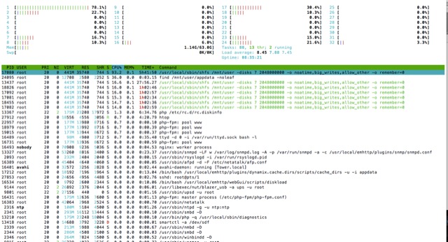

switched off the docker and the virtual manager
installed the new version
run the diagnostics in terminal
was waiting for more than two hours to finish. and it is still going ....
also the Array is STARTING......

meanwhile I have done the upgrade,  while having the virtual manager and the docker switched off.
immediately after reboot, I get the system call.
the array shows in the WEBGUI as "starting..."
in the tools/diagnostics manu, it is stuck on "downloading" after trying to execute it
in the terminal as well:
root@Tower:/boot# diagnostics
Starting diagnostics collection...
attached is the syslog.
also bellow are the last entries of syslog after about 7hours.
took a capture of HTOP output
