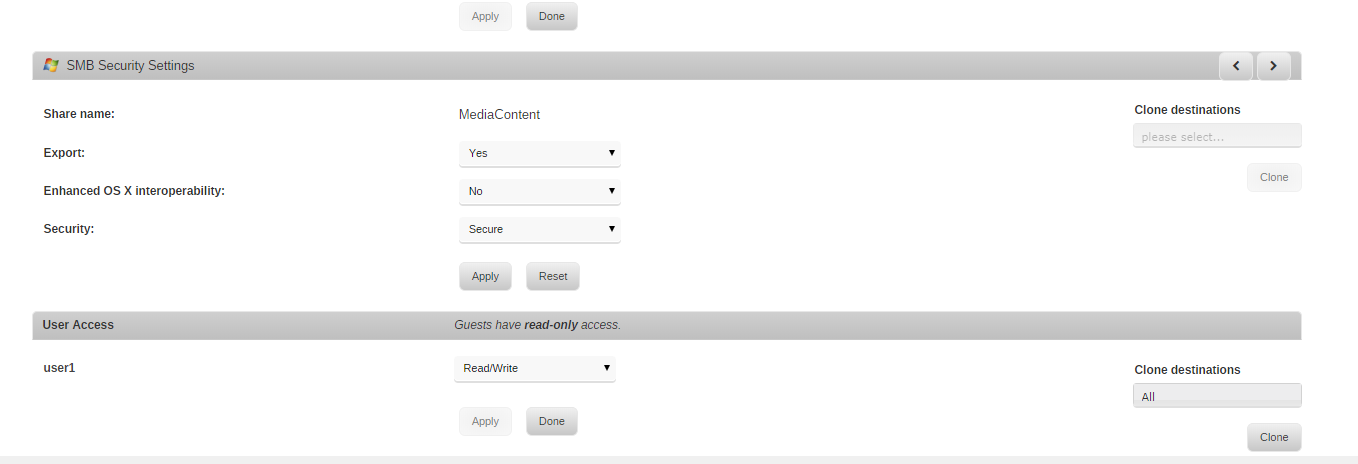

I have created new share for Media, and by default the Security was Public. No problem, just wanted to see if it worked. I accessed this via Windows with no issues.
Since then I have created a new User and wanted to restrict this share. The share is hidden from view in Windows, but I can access it with Read only access. I don't get a prompt to use my credentials for RW access. What am I doing wrong?

Windows will only use one set of credentials per server. It logged in fine with guest credentials, so it's not going to renegotiate since it's already logged in. You need to clear the current server credentials in windows, and restart. When you connect to the server, make SURE that the VERY FIRST connection is to a share that requires credentials. You may need to temporarily disable guest access to force windows to ask for credentials.

That's not going to change anything. Try changing all shares to private instead of secure and clear credentials in windows again. You must force windows to prompt for credentials, or alternatively add credentials to unraid that match what windows is providing by default.

Changing to private and clearing credentials has done the trick on one Windows machine - thanks. I will have to test a few more things tomorrow.
