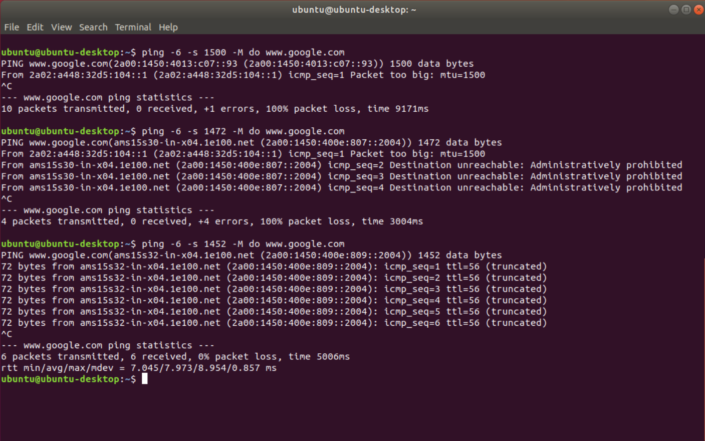

You write that you can't ping over 1450 bytes, which is already strange and indicates that other "overhead" is being added. I presume you are running your server bare metal. All my tests are based on bare metal installation.
1 hour ago, pwm said:
unRAID without jumbo packets can't do ping -s 1500 -M do because the ping doesn't result in MTU 1500.
unRAID can do poing -s 1472 -M do <ipv4>
IPv6 is only 1452 bytes due to the bigger header.
