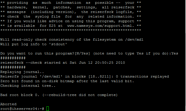

Ok, I have "Replaying journal..
Reiserfs journal '/dev/md1' in blocks 18..8211]: 0 transactions replayed
Zero bit found in on-disk bitmap after the last valid bit.
Checking internal tree.
Bad root block 0. (--rebuild-tree did not complete)
Aborted"
Sitting at the prompt now.

reiserfsck did not suggest the command to run next?  Usually it does.
If it did not, then I'll have to assume the rebuild-tree is next.  But... not with any special commands

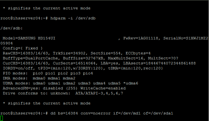

Do you know the device name of the new 2TB drive... this is critical, since if you get it wrong you will be overwriting one of your data disks.
I don't think you have "dd_rescue"  but it probably just uses "dd" as you will on the command line.
The basic syntax is
dd bs=16384 conv=noerror if=/dev/md1 of=/dev/sdX1
Note the "1" on the end of sdX1 and you will need to know the correct letter to substitute for the "X"
Depending on how large the source disk is, this could take 4 or more hours to make the copy.
I just checked via hdparm -i and the 2TB green is sda and the 1.5TB Samsung is sdb.
so to clarify, I'm typing:
dd bs=16384 conv=noerror if=/dev/md1 of=/dev/sda1
Alright. I'll get this underway and hope it completes in that time or less.
Update: should it give some sort of indication of what it's doing? I decided to telnet in to run this command and so far it's just sitting there.
Screenshot attached from 5 mins in. I guess it's working; hdd led is going nuts. Guess I'm too used to cushy windows where you get progress bars with everything haha.

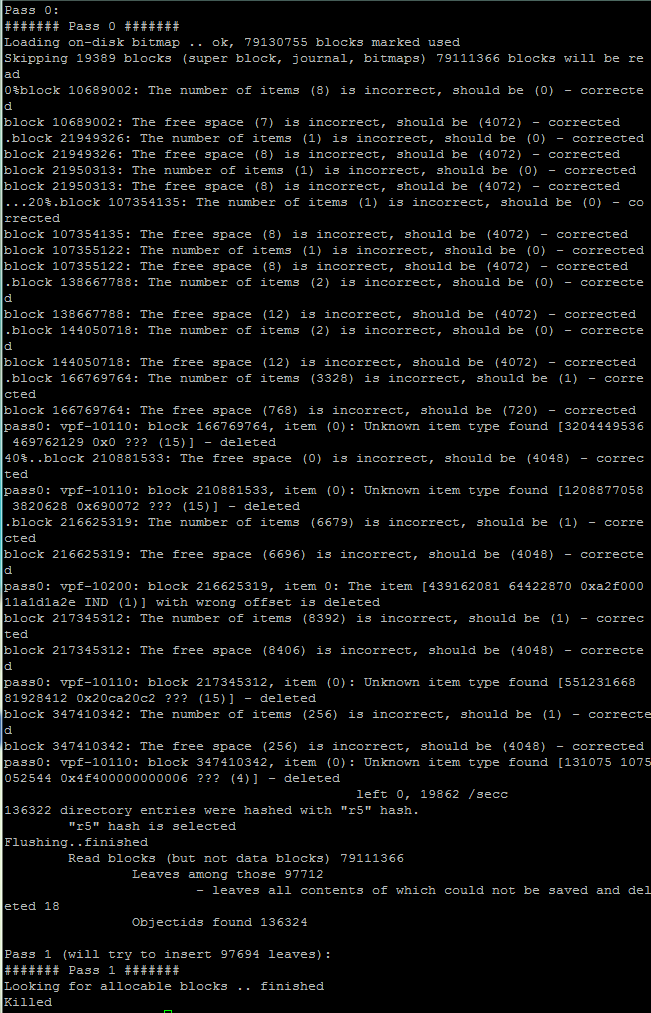

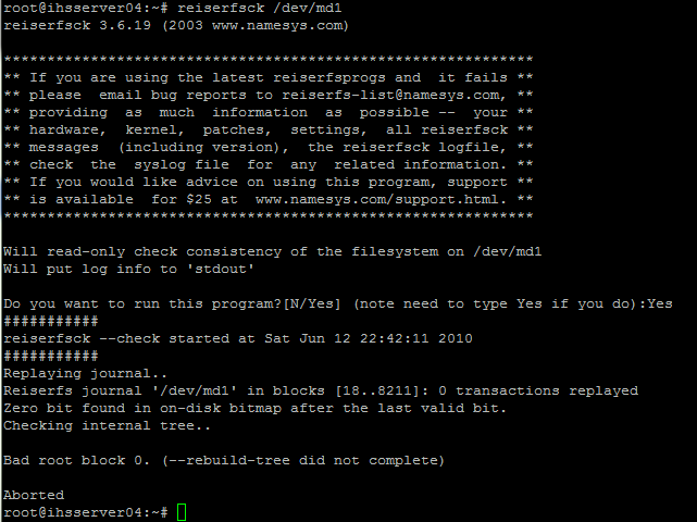

So just as before, reiserfsck /dev/md1 returned the attached error which kept creeping up while trying to rebuild the tree & fix-fixable yesterday.

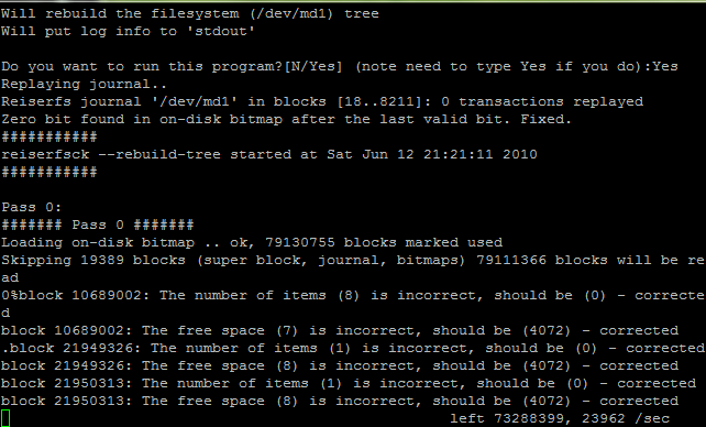

Ok, it is time to re-run the --rebuild-tree but as I said earlier, without the scan whole partition option.
reiserfsck --rebuild-tree /dev/md1
Got it underway. So far, same first line as the last command: "Reiserfs journal '/dev/md1' inblocks [18..8211]: 0 transactions replayed."
I'll leave it be for a bit and see what happens.
Ahh here we go. Lots of stuff is getting corrected, so it seems.

I've never seen it do more than one pass.  It might suggest the next option to use if it can't fix things with the current.
And, we're done! Now what should my next step be?
I'm going to go back and try the general reiserfsck /dev/md1.
...which yielded the exact same results as before :( :( (attached). This isn't good and the weekend is quickly slipping away! That being said, so has the night. Thanks again for the help Joe. I think I'm calling it a night to tackle this with a fresh mind tomorrow.
