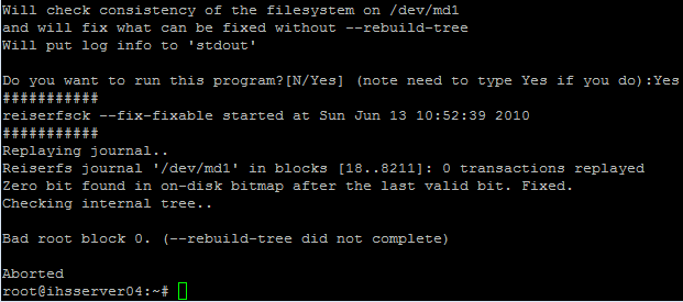

I'd see if the following command can fix the bad root block
reiserfsck --fix-fixable /dev/md1

It says fixed but then still reports a bad root block when running the rebuild tree command.
syslog-2010-06-13-2.txt
Yes, but it still aborts...

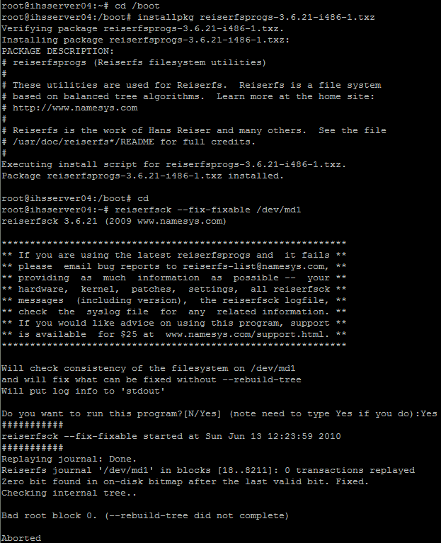

I did some searching on google and found that the version of reiserfsck we have on unRAID has a bug that causes the abort.
I've found the source for a newer version, but not yet an installable compiled version.
Perhaps I'll try compiling it.
We are looking for a version of reiserfsck later than 3.6.19
The bug was apparently fixed in 3.6.20, and the source code I found is for 3.6.21.
Joe L.
Most interesting discovery. This gives me hope again. I've installed the new version and running now.
Update: No such luck. Still aborts. I have never installed packages before. It appears to have installed... should I have maybe tried restarting before issuing the command again?
Tried rebooting for the fun of it and running again. Same result.

You showed me the output of the smart report.  It did not indicste any sectors pending re-allocation.
Your original rebuild-tree was interrupted.  Probably by the bug in reiserfsck when it aborted.  It did not finish the fix of the file-tree in the file-system.
You said you did not know how to install the package.  You also said you rebooted.  You would need to install it again after every reboot.
To install it you change directoy to where you downloaded it.  If you downloaded it to your PC and then moved it to \\tower\flash you would log in via telnet and type
cd /boot
Then type
installpkg reiserfsprogs-3.6.21-i486-1.txz
It will say something like this:
Verifying package reiserfsprogs-3.6.21-i486-1.txz.
Installing package reiserfsprogs-3.6.21-i486-1.txz:
PACKAGE DESCRIPTION:
# reiserfsprogs (Reiserfs filesystem utilities)
# These utilities are used for Reiserfs.  Reiserfs is a file system
# based on balanced tree algorithms.  Learn more at the home site:
# http://www.namesys.com
# Reiserfs is the work of Hans Reiser and many others.  See the file
# /usr/doc/reiserfs*/README for full credits.
Executing install script for reiserfsprogs-3.6.21-i486-1.txz.
Package reiserfsprogs-3.6.21-i486-1.txz installed.
You can see the version number by typing
reiserfsck -V
As far as the file system we copied to the other disk.  We did not set the partition type byte.  It is still a zero from the pre-clearing process.  We did not need to worry about the OS knowing the partition had data since it was not going to be mounted.  That is why your other PC does not see a file-system. (we did not set the byte telling it it had a specific type, we just populated the partition with data from the other drive.)  Please do not write to the 2TB drive.  We have it as a fall-back.  We can be adventurous with the bad disk since we can get back to how it looked before any attempted repair with a single command.  That command would read from the 2TB disk and write it back to the defective disk... still defective, but exactly the same corruption as befor any attempted repair.
If you wish to rebuild the superblock be aware you will be asked a series of prompts.  The correct responses are NOT the default prompts reiserfsck offers.  The correct responses are those pointed to by this post: http://lime-technology.com/forum/index.php?topic=1483
You can then try the
reiserfsck --check /dev/md1
It may still complain, but if not try
and if not corrected
reiserfsck --rebuild-tree /dev/md1
and if it then works try adding the option to scan the entire disk.
If you want to get the disk back to the same exact state as it was when we made the image copy to the 2TB disk type:
dd bs=16384  if=/dev/sda1 of=/dev/md1
That will copy from the 2TB drive to the /dev/md1 disk and we can try a different approach.  The danger of the rebuild-sb option is minimized because we basically have an "undo"
Joe L
I did manage to get it to install the first time but did not realize I needed to install it every re-boot. I'm pretty sure I attempted everything listed after the first install (before rebooting) but it won't hurt to try again just to make sure. This time I'll verify the version number as well. I'll post back shortly.
