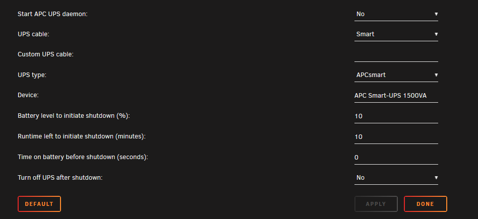

@michael123 would you mind sharing your settings for how you got this setup?  I've tried several with minimal luck.  I was able to get charge and runtime left to display but nothing else.  Thanks in advance for your help!
in my case, I just replaced the cable few times (previous, were also working with other devices for some reasons)

Thanks for sharing!  Would you mind sharing the settings you have for the UPS and did you make any changes to the UPS settings or keep them at default?
Start APC UPS daemon --> Yes
UPS cable --> USB
UPS type --> USB
