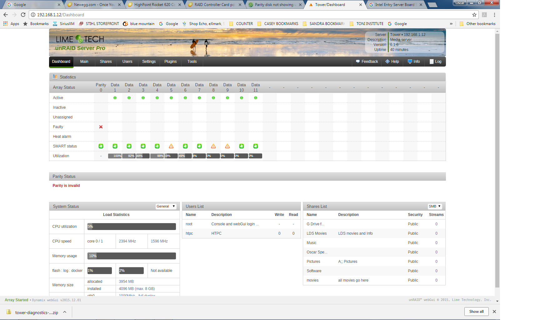

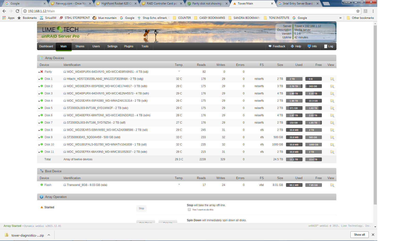

Here are the screens of the main and dashboard

Your dashboard is showing that your parity disk is disabled. It is also showing you have SMART issues with 3 of your data disks.

The disk I replaced was disk 5.  Disk 8 &9 do not have any data on them.  They were extra disks I had and just added to the array.  The pic shows the original disk in the array. I removed the new disk when the parity disk showed disabled. I thought the x was that it was not finding it. (Sigh of relief). Before I removed disk 5 parity was run and checked ok with 0 errors. Can I unassigned disks 8 &9 and rebuild from there?   What is the process to enable the parity drive?

No, parity won't be valid, looking at your first screenshot you did start the array without parity, so it may be no longer valid anyway, also disk8 looks in real bad shape, so a rebuild will likely have corruption, you can still try as long as you didn't make any changes to the array data, this includes starting any VMs/dockers running on the array.
