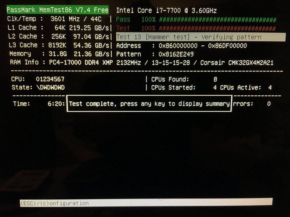

After running the test, zero errors were found.

Memory error comes to mind first. Looks like you ran a 6 hour test, I'd run at least 24 hours.

@SSD Thank you for the reply. I think it may be a cable issue. I did rerun the memory test with no issues and I precleared another drive on the same port with the new cable and had no issues. I just updated to 4.6.1, so I cannot use preclear yet. Once it is available again, I will run it a few more times on the drive to see if I get no errors repeatedly. Thank you for the advice, I will give it a second look.
